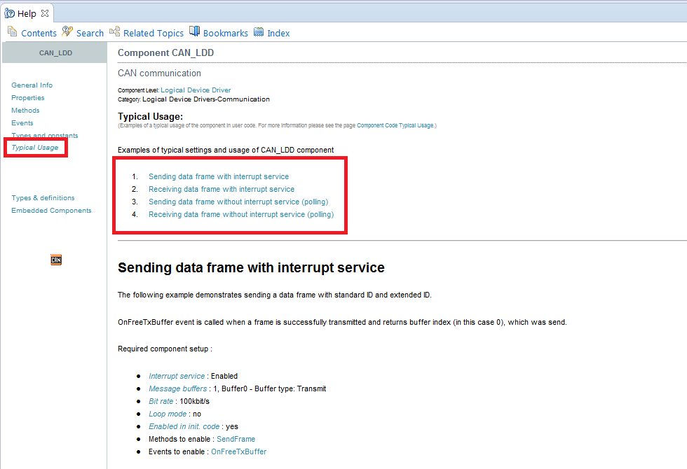

So i was be able to send 8 bytes data through mk20 board, and i simply call can_init() and can_readFrame().
The send device is CANTact. The reading isnt happened. Can anyone explain to me how can_readframe works?
What should I be careful about? Thanks.
Yaran
884 Views
marek_neuzil
I am not sure which component you use. I suppose that you want to use CAN_LDD (according to the name of the can_readFrame() method).
The CAN_LDD component help (open the context menu of the CAN_LDD component in the Components window and select Help on Component) contains Typical Usage page that contain examples - how to use methods of the CAN_LDD component, see below:
