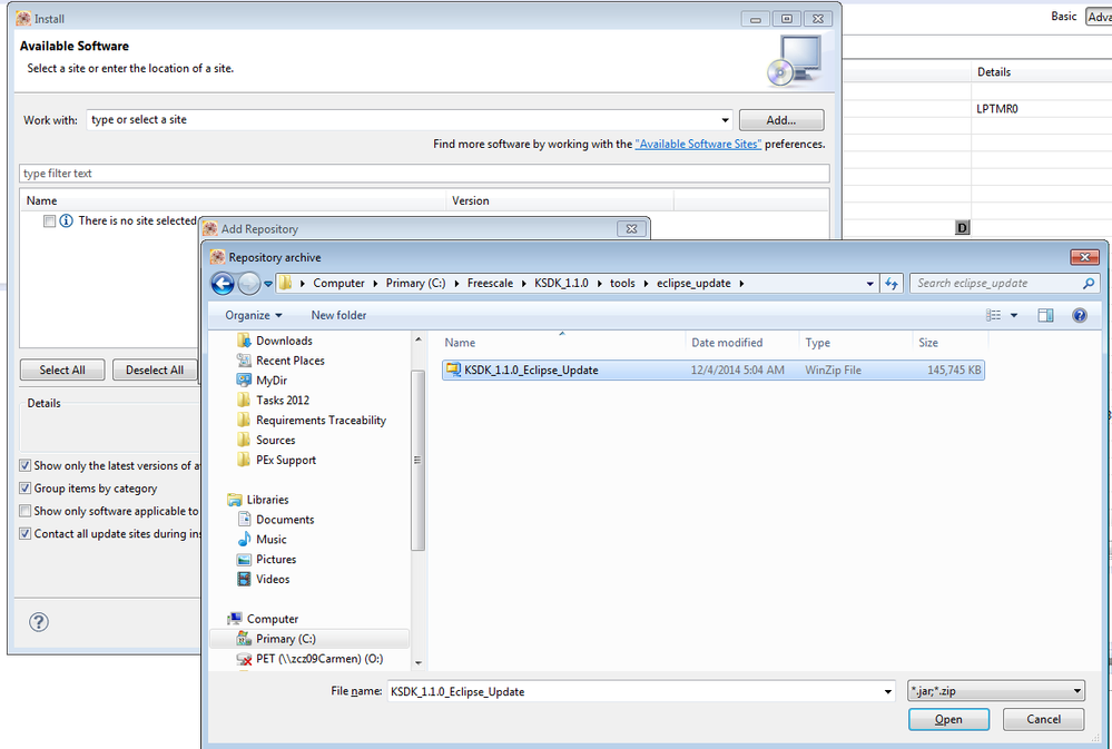

After the KSDK 1.1.0 is installed you need also install the KSDK_1.1.0_Eclipse_Update. In the KDS main menu select Help > Install new software… , click on Add.. button, click on Archive and select KSDK_1.1.0_Eclipse_Update.zip in the KSDK subfolder (e.g. c:\Freescale\KSDK_1.1.0\tools\eclipse_update\KSDK_1.1.0_Eclipse_Update.zip):
