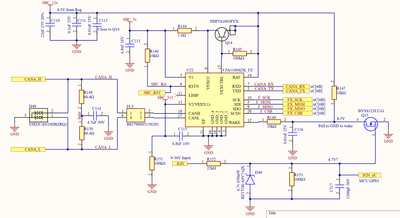

Hi all, I have a UJA1169ATK on my PCB with my S32K148. I am trying to set up my UJA but after the first flashattempt I now no longer get V2 voltage or and CAN transceiver activity as a result. Here is the SPI command string I sent, where have a I gone wrong and can I reset MTPNV or do I have to do the CANH, CANL and RST bit reset?
0xFD00
0xE100
if NVMPS == 1 then continue if not go to "SKIP"
0xE600
0xE804
0xEA7E
"SKIP"
0x0207
0x4002
0x9801
0x4601
Where am I going wrong with this? Any help is appreciated, thank you!

I checked your schematic here but no more issue found!

What am I doing wrong with the SPI commands? Seems to be HW is fine, communication to the UJA is fine so there must be something off in my SPI command routing that is stopping V2 from being activated.

Could you please share with your schematic part of UJA1169?
4,240 Views
Poley
Contributor V
Hi @guoweisun , yep sure. V2 and CAN worked while it was in FNMC and I could read the identification register so I am assuming/hoping everything is ok hardware wise.
