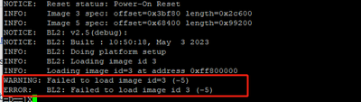

    When s32 evb start from SD, CMD17 occur CRC error in BL2.

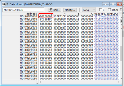

    This is the registers and memory map after send CMD17, it occur CRC error.

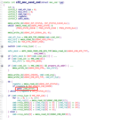

    According to the RM of S32R45, the calculation and verification of CRC values are completed by the uSDHC module, the software ATF don't calculate CRC values and check them, it only gets CRC verification results through registers.
    So, why does it occur CRC error? Is it related to hardware design?  is the design flawed?

    After send CMD17, the register INT_STATUS (402F_0000h + 30h) is 28000h, occur Command CRC error.
