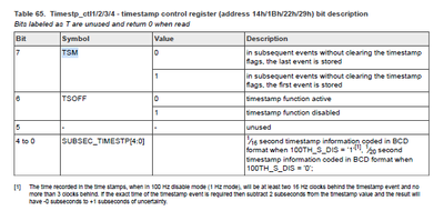

To do so I made the following changes:
function pcf2127_enable_ts in rtc-pcf2127.c
Set TSM (Timestamp mode) to 0.
/* Enable timestamp function. */
ret = regmap_update_bits(pcf2127->regmap,
		        pcf2127->cfg->ts[ts_id].reg_base,
			PCF2127_BIT_TS_CTRL_TSOFF,
			0);
			PCF2127_BIT_TS_CTRL_TSM,
			0);

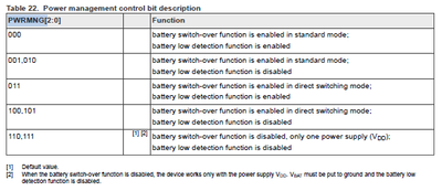

function pcf2127_probe in rtc-pcf2127.c
Enabled switch-over and battery low detection and
set BTSE to 1 and BF to 0 to have the timestamp4 update when switch-over happen.
Reference: page 17 and 43 of the datasheet to find bit map and default values.
	// Set default behavour of RTC
	// Activate switchover and low battery
			PCF2127_REG_CTRL3,
			PCF2127_BIT_CTRL3_BTSE,
			1);
			PCF2127_REG_CTRL3,
			PCF2127_BIT_CTRL3_BF |
			PCF2127_BIT_CTRL3_PWR0 |
			PCF2127_BIT_CTRL3_PWR1 |
			PCF2127_BIT_CTRL3_PWR2,
			0);

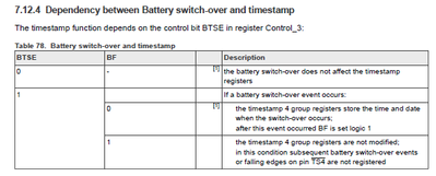

Everything seems to work fine, the RTC time is correct and is maintained when going with the battery. Timestamps correctly overwrite itself when triggered.
The problem are the following:
  • When the system is rebooted (so when RTC does the switchover to battery), all the timestamp register reset and become empty.
  • Some random other time they are not empty after reboot, but filled with the same value with recent date and time.
  • When doing the switch-over TS4 is not updated
Thank you in advande for any help,

Reboot means power on reset for RTC, right ? if yes, all of the RTC registers will be set as default value.
2,972件の閲覧回数
simoberny
Yes, I mean turning the board off and on again. I expect the timestamps to remain saved just as the date and time remain saved by using the battery source power.
This is what an RTC is for, if it resets the timestamp registers every time what are they for?
