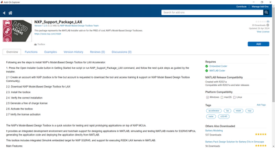

  • Support for MATLAB versions:
    • R2021a
    • R2021b
    • R2022a
    • R2022b
    • R2023a
    • R2023b
    • R2024a

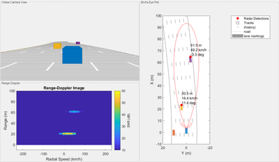

    • MUSIC DoA (updated)
  • Radar processing demo (updated)
      • Range FFT, Doppler FFT, and Non-Coherent Combining offloaded to NXP SPT accelerator
      • MUSIC DoA offloaded to NXP LAX accelerator
