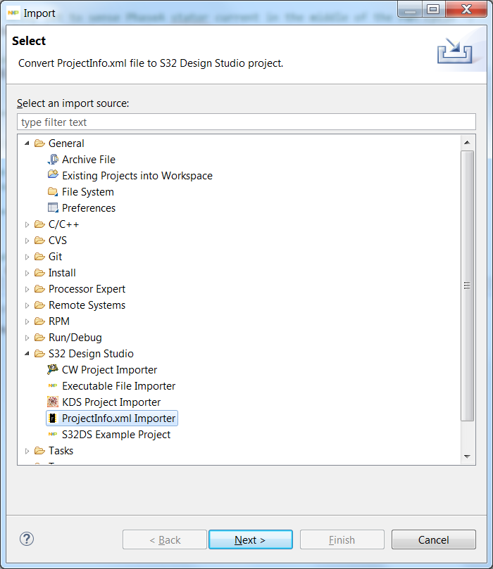

The main problem here is that S32DS for Power Architecture IDE allows project importing only as:
- Existing Project Into Worskpace
- ProjectInfo.xml Importer
Due to project complexity we have choose (based on the feedback we have received from S32DS Team) to use the XML import option.
Unfortunately, the S32DS does not have a scripting interface (or at least i'm not aware off) to allow IDE commands automation, in order to go thru automatically via all various options to import and build the project.
It might be possible using an external plug it such as RCP Testing Tool (RCPTT) to control the IDE (i'm not sure if S32DS supports all classes needed by RCP). If that is doable - then you&us could potentially modify the mbd_pnt.tmf
to run a command (start a script) via the makefile as post build.

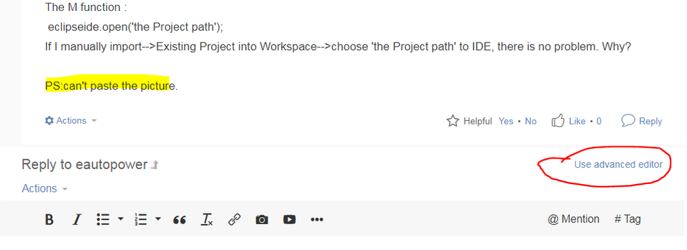

PS:can't paste the picture.

For "picture issue" you could use Advance Editor
and then: insert picture

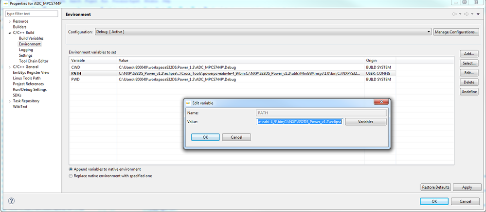

Could you possibly post here the content of your PATH variable in S32DS?
Just go to project properties -> C/C++ Build -> Environment -> PATH -> Edit
Please select and copy all the variable content and paste it here.
Could you also attach your xml file?
This will help us to resolve this issue much faster.

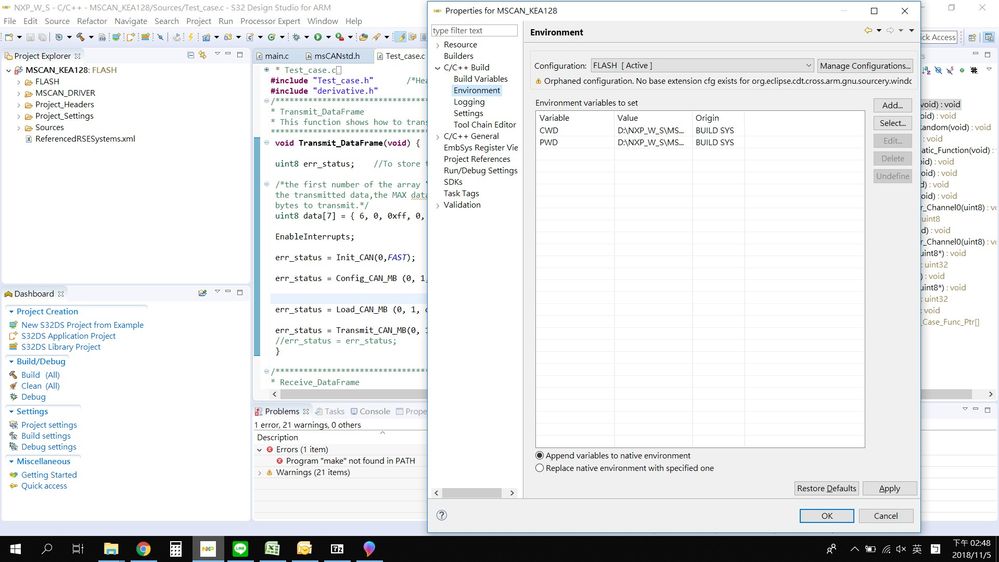

pg31321
I Have the same problem.
My "path" is disappear.
How can I create it?

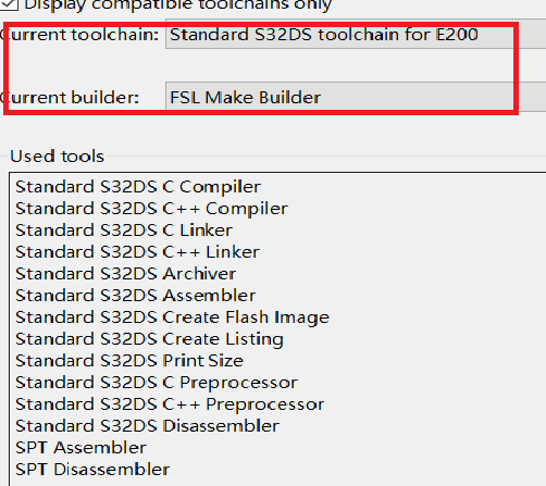

eautopower
hello:
I found that the project is open with the 'eclipseide.open' function,but  the project environment is the most original setting, like the compiler is not useful for MPC5744P. and the include is null
however,the manually import the project,all seting is ok,
How can I import MPC5744P related settings directly and effectively?
