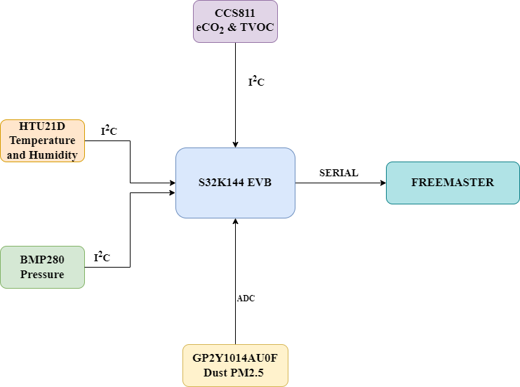

3. APPLICATION OVERVIEW
The application displays in FreeMASTER the values of temperature, humidity, dust density, pressure, and the values of eCO2 and TVOC. Those values are read from the sensors connected to the EVB and computed using the algorithms from the libraries corresponding to each sensor, such as Adafruit’s libraries for BMP280 and CCS811, Sparkfun library for HTU21D and the GP2Y1010AU0F library, which are then adapted in Simulink logic. The application will be split into four subsystems, each covering a sensor and its algorithm.
BLOCK DIAGRAM
                                                    Figure 1: Block Diagram

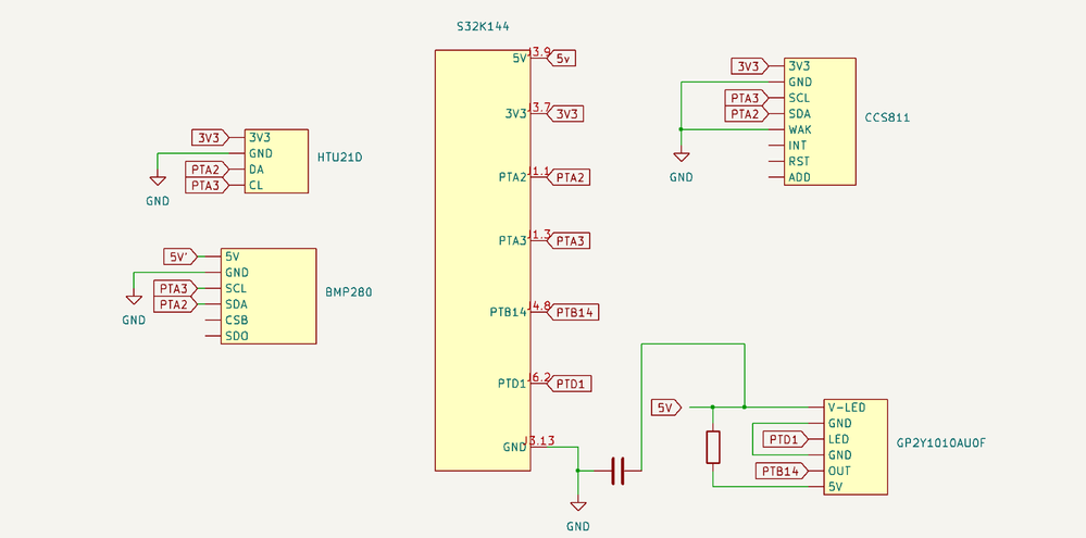

4.2. Electrical schematic
Apart from the components described above (HTU21D sensor, CCS811 sensor, BMP280 sensor and GP2Y1010AU0F sensor), a resistor and a capacitor will be needed.
The following electrical schematic is an example of how the sensors can be connected:
                                                          Figure 2: Electrical schematic

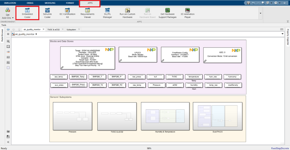

5.2. Model overview
The application uses the Simulink environment to implement the algorithms for computing the data read from the sensors connected to the S32K144 EVB. The model is organized into two big sections: initialization and sensors’ algorithms. For the sensors part, each sensor has its subsystem where the algorithm is implemented.
                                                   Figure 3: Application’s model

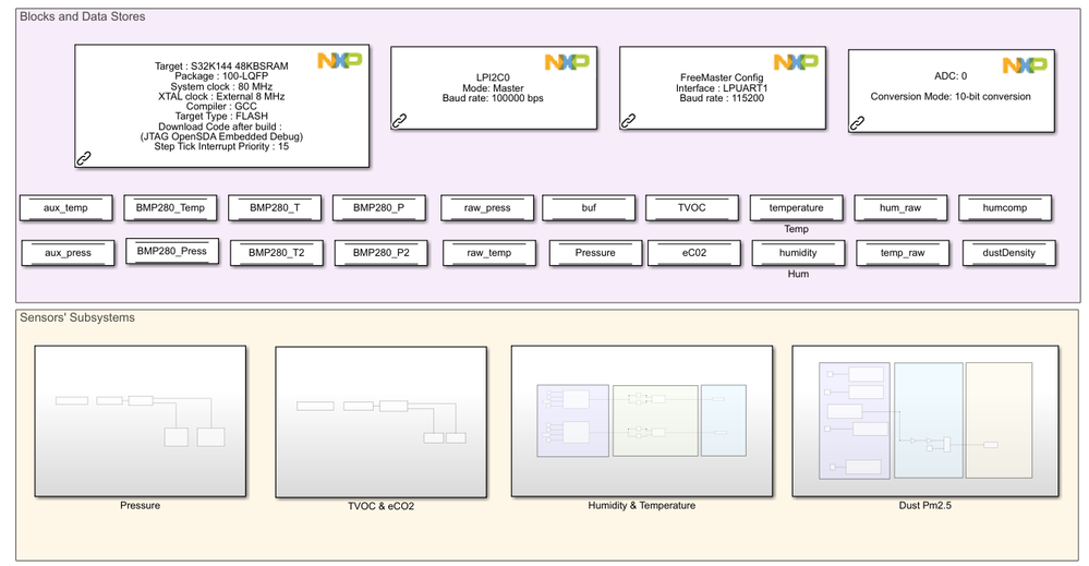

5.3. INITIALIZATION
The initialization holds the blocks required for our model to work. On the first line, from left to right, the following can be found:
    1) The Configuration block for S32K1xx processor family. The required settings of the processor configuration block are the default ones, except for the processor family and the download interface.
                      Figure 4: Configuration block for S32K1xx family of processors

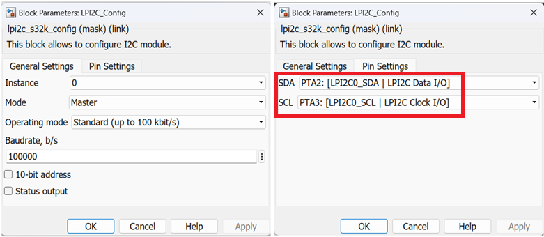

    2) The LP2IC Configuration block. Here the functioning mode (master or slave) can be changed, and the pins used for communication can be chosen. This application has three sensors that use this communication protocol:
  • BMP280, whose address is 0x76
  • CCS811, whose address is 0x5A
  • HTU21D, whose address is 0x40
                                        Figure 5: Configuration block for LPI2C

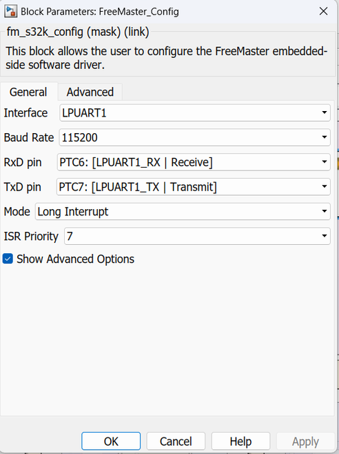

    3) The FreeMASTER configuration block. Here the communication interface, the baud rate, and long interrupt serial communication can be set. This component facilitates communication between the S32K144 EVB LPUART1 instance and the FreeMaster tool, via the microUSB serial port.
                            Figure 6: Configuration block for FreeMASTER
    4) The configuration block for ADC. The ADC converter number and the resolution mode can be selected from here.
 Figure 7: Configuration block for ADC
On the second line, the data stores for the variables used in this project can be found. The data type and size for the data stores can be found in the following table:

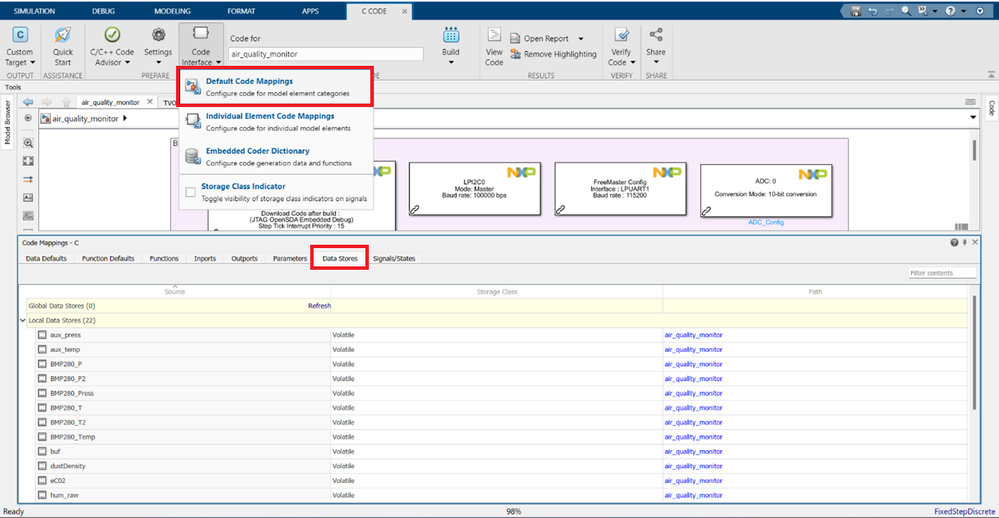

Note! It is important, for the variables to be visible in FreeMASTER, to go to Apps -> Embedded Coder -> Code Interface -> Default Code Mappings -> Data Stores and set all the variables to Volatile.
 Figure 9: Embedded Coder selection
Figure 10: Default Code Mappings

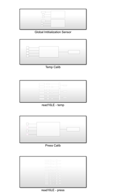

For this sensor’s initialization, BMP280_Temp and BMP280_Press will  be used. Top down, five subsystems can be found: Global Initialization Sensor, Temp Calib, read16LE – temp, Press Calib, read16LE – press.
 Figure 11: BMP280 subsystems
The purpose of the Global Initialization Sensor is to prepare the sensor for subsequent data reading. This involves transmitting specific data to the sensor using the LPI2C Master Transmit block. These data include values such as 0xF5 and 108, as well as 0xF4 and 111, which serve to configure and calibrate the sensor for upcoming tasks. Having multiple sensors connected using I2C communication protocol, the way the sensor can differentiate between them is by their address. Therefore, the data will be sent to the 0x76 address, which corresponds to the address of the pressure sensor.

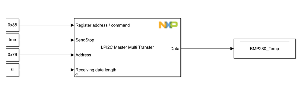

In Temp Calib subsystem, data is read from the temperature's memory location and placed into the BMP280_Temp data store mentioned earlier. The addresses from which data needs to be read are sequential, so reading begins from the 0x88 address and 6 bits of data are requested, resulting in reading from address 0x88 to address 0x8C inclusively.
Figure 13: I2C Master Multi Transfer

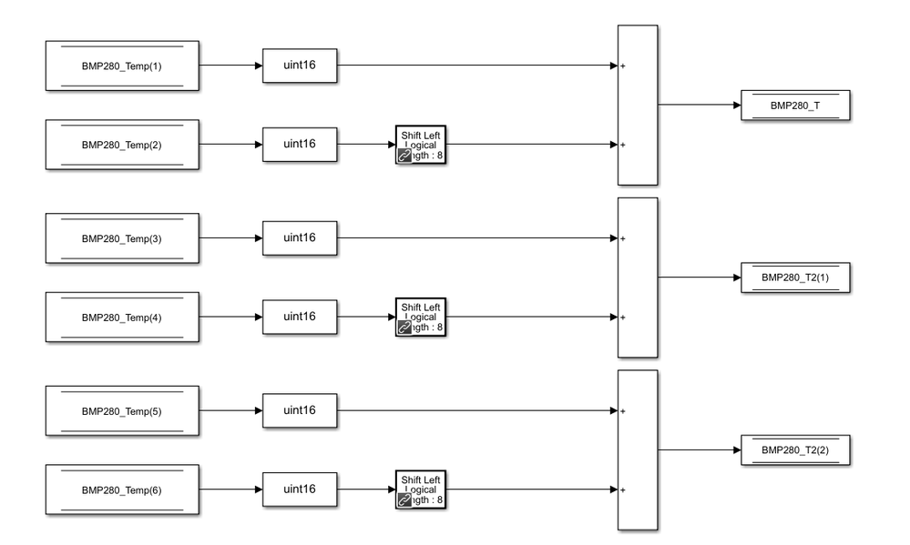

In read16LE – temp subsystem, the add operation is utilized to perform an OR bit operation for calibrating the data and placing it into the BMP280_T data store and the BMP280_T2. LE stands for Little Endian.
Figure 14: Temperature data calibration
For the Press Calib and read16LE – press subsystems, the same operations described previously are performed, but for a greater number of bits. After the initialization is completed, the Else subsystem is entered, where the computing takes place. An auxiliary temperature is computed, which is required for the pressure's formula. For this purpose, the data store named aux_temp will be used. Within this subsystem, there are 2 further subsystems: READ TEMP REGISTER and RAW TEMP.

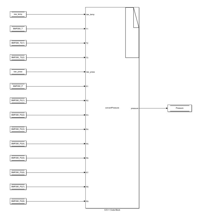

Similar to the temperature calculation, the pressure calculation data is read from the 0xF7 address into the data store named aux_press, and then the raw_press required for the formula is computed.
For the actual computation of the pressure, an S-Function block with C code inside is utilized, where the algorithm found in the Adafruit Library for BMP280 is included. [1] [functions float Adafruit_BMP280::readTemperature() and float Adafruit_BMP280::readPressure()].
Figure 15: convertPressure S-Function

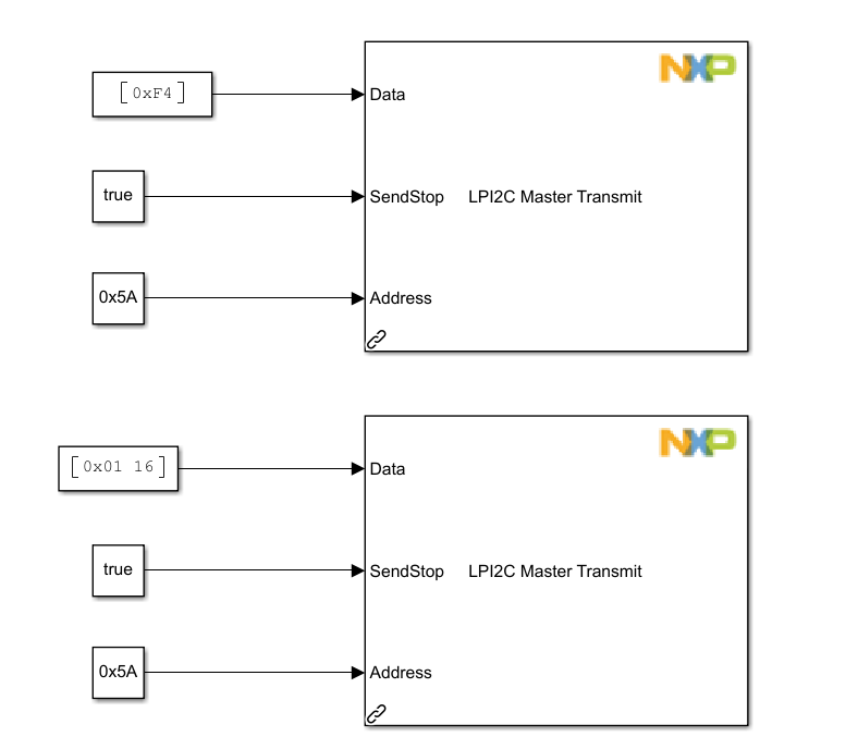

For this sensor, during initialization, the same procedure as before is followed: specific data is sent to the sensor using the LPI2C Master Transmit to notify it of the upcoming data reading. Specifically, the predefined data 0xF4 and 0x01, 16 is now transmitted.
 Figure 16: Initialization for eCO2 and TVOC sensor

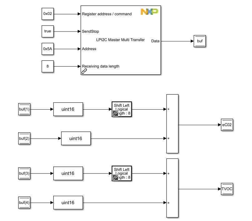

In the Else subsystem, 8 bits of data are read and placed into the buf variable using the LPI2C Master Multi Transfer block. Subsequently, after the necessary data is retrieved from the sensor, the required values are computed, with their formulas sourced from the Adafruit Library for the CCS811 sensor [2]:
_eCO2 = ((uint16_t)buf[0] << | ((uint16_t)buf[1]);
_TVOC = ((uint16_t)buf[2] << | ((uint16_t)buf[3]);
Figure 17: Compute data for eCO2 and TVOC values

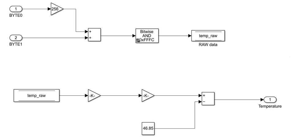

For both of them, the raw values need to be computed. The formulas needed are:
  1. For temperature:
uint16_t rawValue = ((uint16_t) msb << | (uint16_t) lsb;
temp_raw = rawValue & 0xFFFC;
     2. For humidity:
hum_raw = rawValue & 0xFFFC;
The temperature is computed using the following formula:
Temperature = temp_raw * (175.72 / 65536.0) – 46.85;
Figure 18: Temperature computing

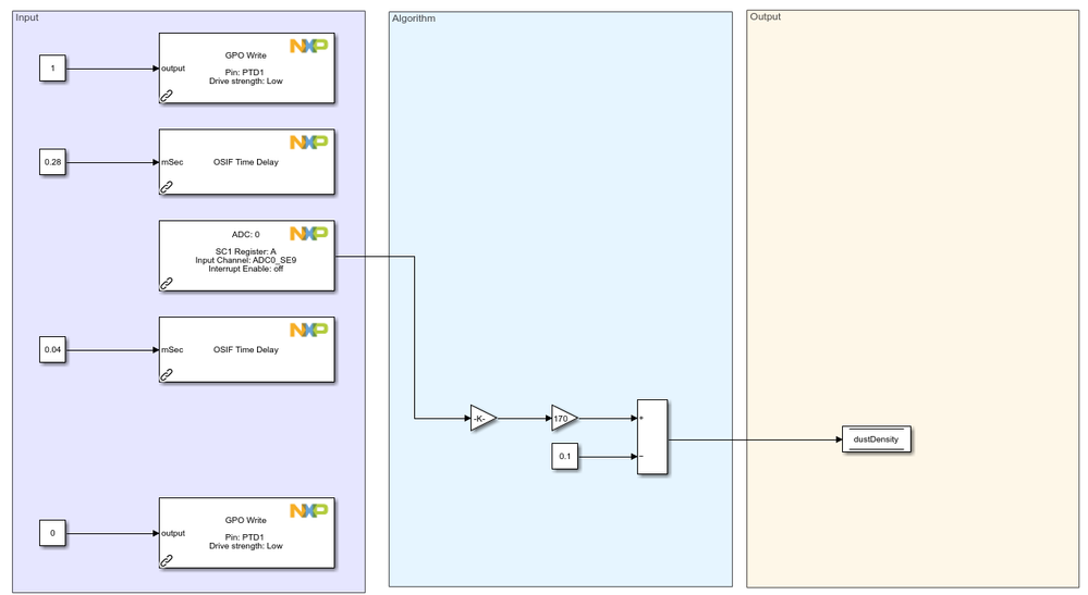

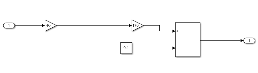

For this final sensor, an additional library [4] will be employed to implement our model-based design algorithm for measuring and computing the PM2.5 levels in our surroundings.
 In this scenario, the GPIO Write block will be utilized to activate and deactivate the infrared LED on the sensor. Following activation, a 0.28ms delay will be introduced before employing the ADC to read the data, which will then be computed using the provided formula:
dustDensity = (170 * 5 / 1024 – 0.1) * Voltage
Figure 21: Formula applied for dust density
After applying the above-mentioned formula, another delay of 0.04ms will be used and then the LED will be turned off.
Figure 22: Dust Pm2.5 subsystem

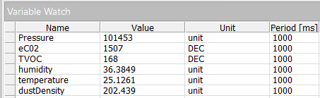

5.5. FREEMASTER
To visualize the results from the application, a FreeMASTER project can be created. Once created, the .elf file of the built application can be added by navigating to Project -> Resource files -> "pack" directory setup -> MAP Files -> Default symbol file.
Variables can be added to the Variable Watch section. For this project, the most important ones are Pressure, eCO2, TVOC, humidity, temperature, and dustDensity.
Figure 23: Variable watch section

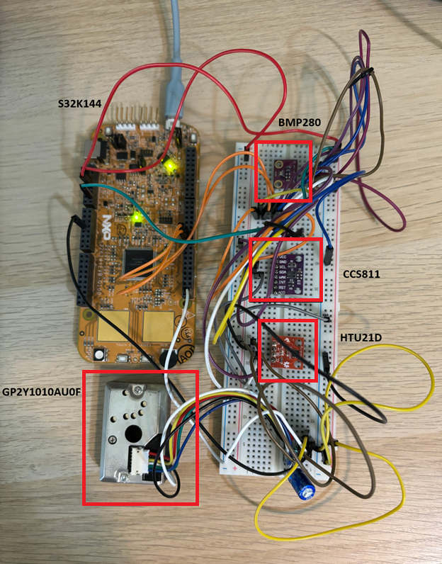

5.6. HARDWARE SETUP
A possible example for hardware setup is represented in the below picture:
Figure 24: Hardware setup
