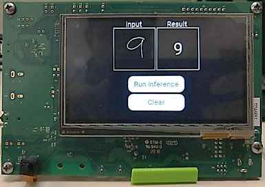

Description
Application demo uses a model trained off the MNIST dataset to recognize individual handwritten digits written on the touch sensitive LCD screen. Thie model conversion can be found here: https://community.nxp.com/docs/DOC-344227.
Software
The RT1060 SDK should already be installed in MCUXpresso IDE. Drag-and-drop the .zip file into the Project Explorer view, and then compile and flash.
