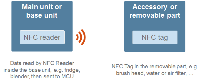

Into the scope of a consumable or accessories authentication via NFC, there are always two components involved.
  • On the one hand, there is one main unit. This is the device where you can plug the part or the accessory. Typically, this main unit would include an active NFC reader.
  • On the other hand, the consumable or replacement would include and NFC tag.
The NFC reader in the main unit can detect when the removable part is connected. As soon as the replacement is connected, it reads the information stored in the tag and uses it to verify the accessory originality. Precisely, the information and security features implemented in the tag is what allows the main unit to:

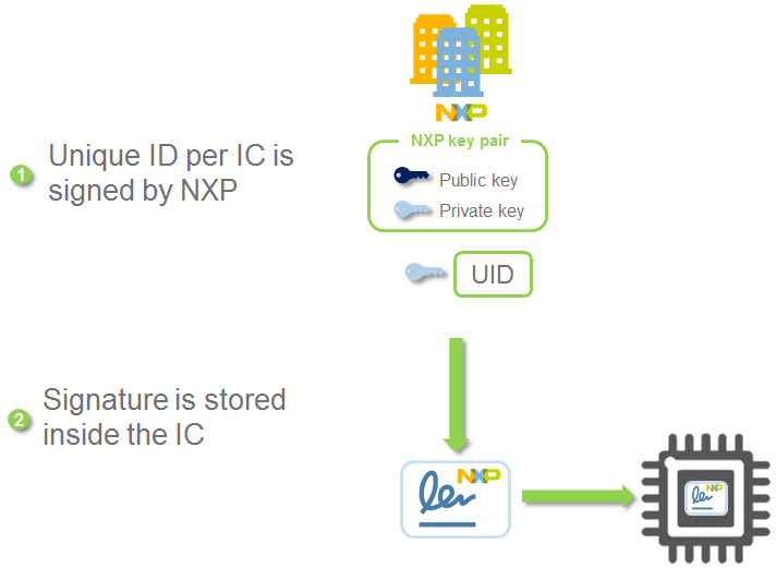

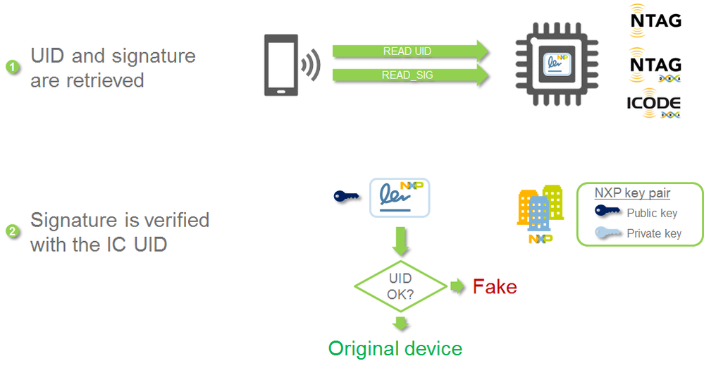

NXP originality signature
The originality signature implemented in NTAG and ICODE families is based on standard Elliptic Curve Cryptography. NXP generates a ECC key pair (a public and a private key) that are stored in a secure server. In asymmetric crypto, a signature is generated by a signing algorithm given a message and a private key. During production, NXP takes care of provisioning a die-individual signature in each IC. This signature is generated using the tag’s UID and the NXP private key. Since each tag has a different UID, a unique signature is stored in each tag. Therefore, the tags leave the NXP factory already with this unique signature pre-programmed in the IC memory.
These pre-provisioned tags are integrated by OEM into their final devices & accessories. On the field, the originality signature verification process is as follows:
  1. First, the reader unit reads the tag UID.
  2. Second, the reader retrieves the tag signature with the READ_SIGNATURE command.
  3. Third, the reader can verify this tag originality signature using the corresponding ECC public key and the tag’s UID.
With this feature, it is possible to verify with confidence that the tag is using an IC manufactured by NXP and not a cloned IC. In case that the public key is stored in the reader, the entire process can be performed offline. The products supporting this functionality are: NTAG21x, NTAG413 DNA, NTAG I2C plus, NTAG21x F and ICODE SLIX2.

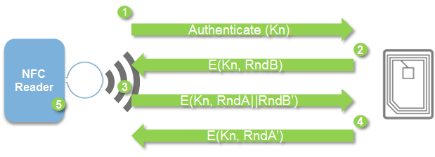

AES three-pass mutual authentication
The last tag security feature is the AES mutual authentication, which is supported by our NTAG 413 DNA as well as the ICODE DNA. The mutual authentication:
  • It is based on a shared secret key known by both endpoints
  • It allows us to verify both ends of the communication (not just the accessory).
The AES 3 pass mutual authentication consist of probing to the other end the knowledge of a secret, in this case, the knowledge of a secret AES key. As we do not want to share in plain this secret over an unsecure channel, the mechanism is based on the encryption of random challenges using this secret key. If both ends are capable of verifying this random-challenge scheme, they demonstrate that the other end knows the secret, and therefore, they prove their authenticity.

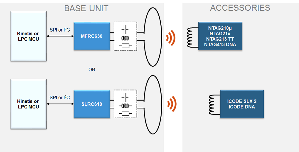

NFC frontends comparison
Regarding the NFC readers for the base unit side, we most ideal solutions are:
  • The SLRC610 plus if your application needs a reading distance of tens of centimiters. The SLRC610 supports ISO15693 and is fully operational with our ICODE family.
  • The MFRC630 if your applications needs a reading distance of a few centimiters. The MFRC630 supports ISO14443-A and is fully operational with our NTAG family.

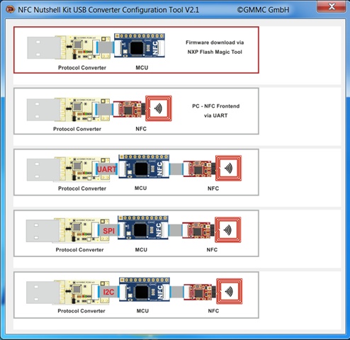

Modes of operation for the USB protocol converter module
In our case, out of the different host interface modules, we select the USB to I²C, UART and SPI converter. This single module itself has several configuration options. As part of the kit, a USB Protocol Converter Configure Tool is provided to easily configure the different operation modes of this component.
The user can open this tool and check the different options:
  • The first one is used when the converter is connected to an MCU. It configures the module for an in-system-programming, which means we can use NXP Flash Magic Tool to program the MCU flash memory.
  • The second option, the development PC communicates directly to the connected NFC frontend via UART.
  • Last, we have 3 bridge modes for single protocol conversion. The Host system can send the any command over the USB interface and it will be converted to the chosen protocol, either I²C, SPI or UART.

USB converter module configuration
Before going to the software development itself, we need to configure the USB protocol converter. The USB protocol converter mode of operation configuration is a straight forward process. We just need to execute the Configure Tool provided in the kit, and select the mode compatible for Flash Magic.  In this case, this setting corresponds to the first choice as shown in the screenshot.

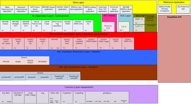

Software development with the NFC Reader Library
For the application software development, we leverage on our well know NFC Reader Library. The NFC Reader Libary is a complete API for developing NFC and MIFARE-based applications, it is free of charge and the latest release can be downloaded from www.nxp.com/pages/:NFC-READER-LIBRARY. Great news is that the NFC Reader Library has:
  • Native support for the modules we selected out the NFC Nutshell kit (the CLRC663 plus and LPC1769)
  • Supports the proximity and vicinity RF protocols.
  • And also, the commandset of Type 2, Type 4 and Type 5 tags.
Therefore, we can focus on developing the application logic rather than spending time on implementing drivers or the RF protocols. For that, we do not even need to start from scratch, because we can take as reference any of the eleven software examples. Each of these examples do not make use of the entire library, but just use the NFC Reader library components required for the use case demonstrate, allowing to reduce the overall memory footprint.

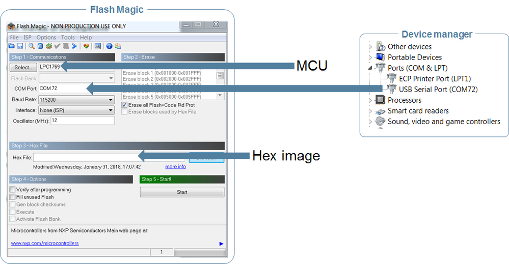

Flash the MCU image with Flash Magic tool
With the .hex file generated., the last step is to flash our MCU with this .hex file. In the Flash Magic tool menu, select:
  1. The MCU used, in this case LPc1769
  2. The COM port, which can be found in the Windows device manager, in our case COM72
  3. Select the path to the .hex file
  4. Click start
Once the flashing is completed, the USB converter setting should be changed to I2C or SPI configuration. At this moment, the solution is running and the application will try to authenticate any tag presented in front of the reader.

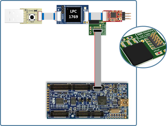

Debugging mode
Optionally, the NFC Nutshell kit also incorporates a code debugging mode. For that, there is an extra HW module compatible with LC1769 and LPC11U68 that can be used to interface with an LPC-Link2 debug probe.
