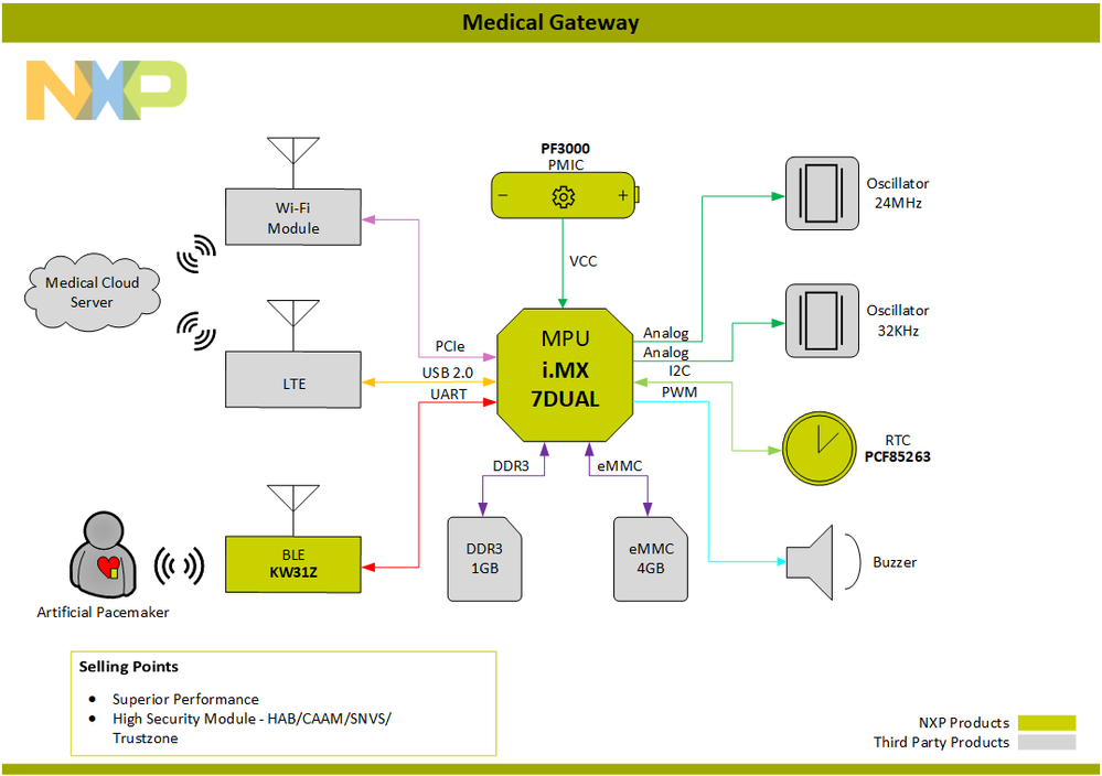

The convergence of an aging population and breakthrough technological advances has created endless opportunities for automated medical devices.
These devices help ensure the future health of millions of people by providing advances in diabetes care, cardiac care, drug deliver, therapy adherence and general health and wellness applications. Regardless of the end use, developers of healthcare/medicals devices face similar challenges – the need to balance processing requirements with power consumption, support to ensure a fast time-to-market, the need for secure wireless connections and product longevity are all key to healthcare designers.
This application receives information of all the sensors in a human body and upload this in the cloud, with this measurements the consumer can check his health if this has an illness.
The i.MX 7 DUAL is a high performance MPU with high security modules to ensure the integrity of the information transmitted and received.
Use Cases
  • Consumer: Gather the information of all the sensors in the human body for health or sports training.
  • Biomedical: Check the vital signs of a patient and uploaded it to the cloud, quick alerts if the patient is in danger.
Block Diagram
Products
Category MPU
Products URL i.MX 7Dual Processors - Heterogeneous Processing with dual Arm® Cortex®-A7 cores and Cortex-M4 core
Product Description The i.MX 7Dual family of processors represents our latest achievement in high-performance processing for low-power requirements with a high degree of functional integration.
Category Power Management
Product URL PF3000: 12-Channel Configurable PMIC
Product Description The PF3000 power management integrated circuit (PMIC) features a configurable architecture that supports numerous outputs with various current ratings as well as programmable voltage and sequencing.
Category Wireless
Product URL KW31Z: Kinetis® KW31Z-2.4 GHz Bluetooth Low Energy Wireless Radio Microcontroller (MCU) based on Arm...
Product Description The KW31Z is an ultra-low-power, highly-integrated single-chip device that enables Bluetooth® low energy v4.2 RF connectivity for portable, extremely low-power embedded systems.
