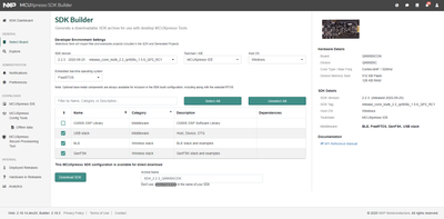

  1. Get the QN9080 SDK form SDK Builder

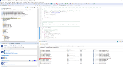

  2. Install the QN908x SDK into your MCUXpresso

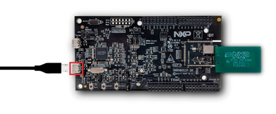

  4. Connect properly the NTAG antenna from the kit as shown in the Hardware Diagram.
  5. Connect the QN9080SIP-DK using a micro-USB cable.

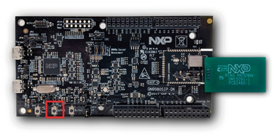

  6. Flash the project into the board and Push Button 1 from the board while running.

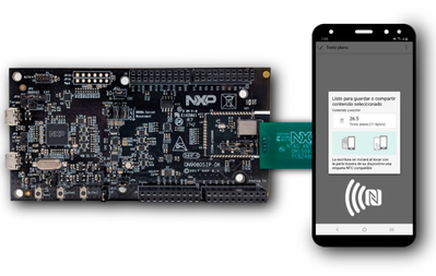

  7. Open the TagWriter App from your phone and select the Write option.
  8. Create a New Plain text element and write any positive float number (< 0.0).
  9. Select the Save and Write button.
  10. Approach the phone into the NFC antenna.

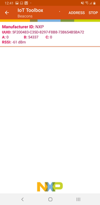

  11. Press Button 1 again to restart the BLE advertising
  12. Open the IoT Toolbox App.
  13. Select the Beacons option.
  14. You should be able to visualize the new payload messages from the device.
Note: These messages are representation in decimal from the actual 4-byte (32-bit) number. Each letter is composed of 2, 8-bit numbers. This RAW representation is for proof of concept purposes. This application can be replaced by another BLE device in scanning mode to perform a data post-process.
