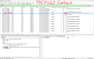

We are building General Purpose card reader using PN7462AU.
Hardware PNEV7452C Eval board.
SDK: FLEXERA Rev 07.09.00 Sep 6, 2023 10:00:00 NFC-LIBRARY-SOFTWARE
Project PN7462AU_ex_phExCcid
We've run into issue, that some cards do not work properly with Contact interface.
It happens only with some cards.
Card without the issue:
Card with the issue, but no issue using NFC
Cards without NFC and with the issue
All of the above cards are working correctly with different readers:
Alcor Micro Alcorlink
Gemalto HWP117685E

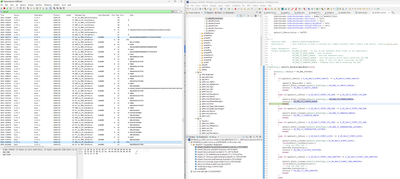

Issue:
After ATR and first APDU request from PC, there is PHPAL_CT_T1_MAX_RETRY_COUNT error phpalCt_ReceiveGeneral(pbReceiveBuff) in phpalCt_NegoIfsd() function.
The error is ignored in FW, 254 (ICC_MUTE CCID timed out while talking to the ICC) on CCID.
Response to this is taking about 5 seconds.
This use case can be tested with C2300 card and this webside using FIDO passkey https://webauthn.io/

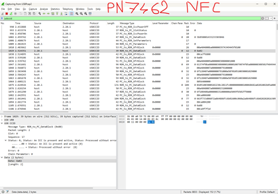

Using NFC or other Contact reader works fine with no issue.
With other cards, the first APDU fails with error 254, the communications continues for a while, but then it stops at some point with card not responding to APDU. I am not sure if root of the problem is that the IFSD was not completed correctly at the begining. But it might be, bacause the C2300 card is responding with ICC_MUTE on every request.

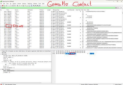

Communication with Gemalto reader, working correctly with no issues
