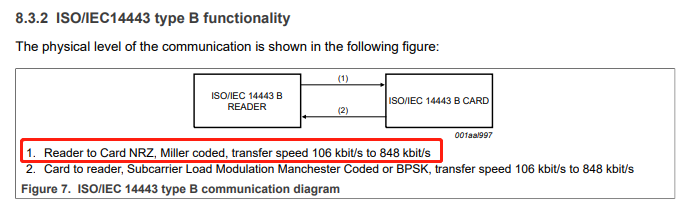

hello, everybody:
I have a question about CLRC663 how to transmit data with Miller coded but not NRZ in ISO14443B.
I saw that there are some description about data with miller coded.
It is in the 8.3.2 part ( ISO/IEC14443 type B functionality ) of datasheet (High performance multi-protocol NFC frontend CLRC663 and CLRC663 plus).
And I've seen three registers for miller encoding, 9.16.3 TxDataMod, 9.16.12 TxSym10Mod Reg, and 9.16.13 TxSym32Mod.
I tried to configure them as follows but it seems not to work.By the way, I using the RC663 without library.
Rc663_WriteRegister(CLRC663_REG_TXDATAMOD, 0x50);
Rc663_WriteRegister(CLRC663_REG_TXSYM10MOD, 0x50);
Rc663_WriteRegister(CLRC663_REG_TXSYM32MOD, 0x50);
So, I miss anything in the configuration or I configured it wrong.?
If it were possible to configure Miller coding in ISO14443B using CLRC663?
