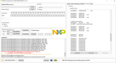

Is there an example for using the CLRC663 commands to read an ISO15693 tag? I am able to successfully access the CLRC663 registers over I2C but am looking for a guide on how to configure the registers and which commands to use to successfully read a tag as it appears that many of them need to be adjusted. I would just like to read the UID of the tag. Thanks.

mgaschler
Hi @fangfang,
Thank you for the reply. I have a few questions:
1. What is the .jcf file?
2. When I try to run the attached script in Cockpit, I get the following error: 
Do you know why this may be happening?
Thanks.
11,463 Views
mgaschler
Hi @fangfang,
I believe I found the issue with the above error. It looks like line 72 was missing a colon and should have been:
:L_WaitTransceiveFinished
ReadRegister IRQ1_REG $test
JumpIfBitN $test 0x40 :L_WaitTransceiveFinished
When I made the change, I no longer get the error. However, now my Cockpit crashes when it reaches this part of the code. After doing some testing, I discovered it was because the value of IRQ1_REG is 0x43, not 0x40, so it gets stuck in an infinite loop. Do you know how I can fix this? If I change the 0x40 value to 0x43, it fixes the infinite loop problem but then I receive no data in the FIFO when trying to read an NFC tag. Thanks.

mgaschler
Hi @fangfang,
