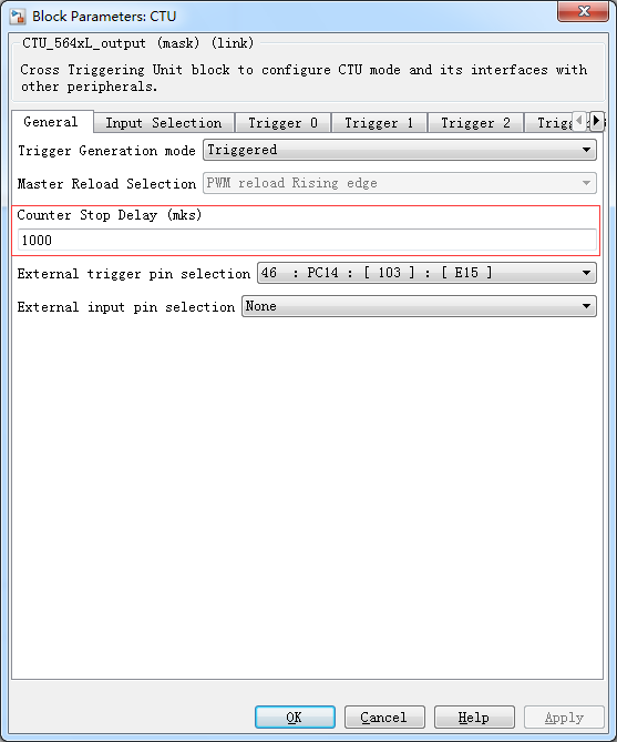

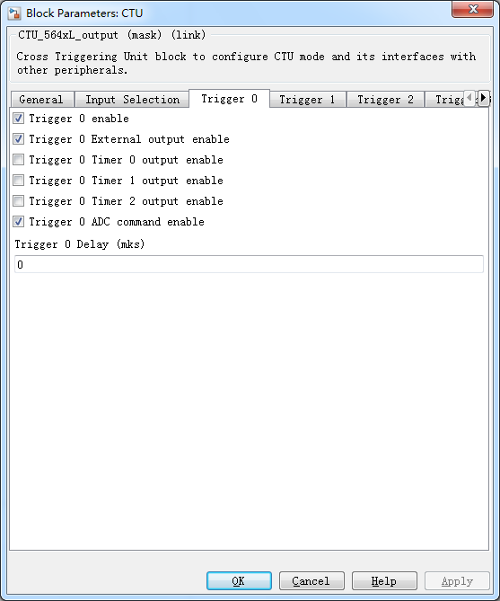

  Now I use Motor Control Toolbox for MPC5643L.In the CTU,I do not know how to set the Counter Stop Delay(mks) and the Trigger x Delay(mks).Can you help me?

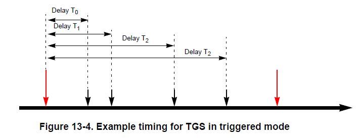

Counter Stop Delay - defines the period when TGS Counter loaded with TGS Counter Reload Value reaches TSG Counter Compare Value while Trigger n Delay defines period when TGS Counter loaded with TGS Counter Reload Value reaches Trigger n Compare Value, in other words the Trigger n Delay is a subset of Counter Stop Delay. And because a picture worth a 1000 words:
Counter Stop Delays  may refers to the red arrow time interval if you count for the whole time interval between events (or might be lower than than)
Trigger n Delay refers to the time interval between red (when event has occurs) and black arrows (when you take the action).
Let's come back to the initial example with current measurements: Basically you want to set up the Counter Stop Delay to PWM period in order to measure the current each time the PWM gets updated. Then you will have to set up the Trigger n Delay to a certain time in order to sample and measure the current via ADC only when the current is reaching the steady state flow thru the shunt.
So, playing with the value of Trigger n Delay you control the moment when the ADC will actually read the value after the lower transistor is in conduction.

[Figure 13-4] : 2 different [T2] ?

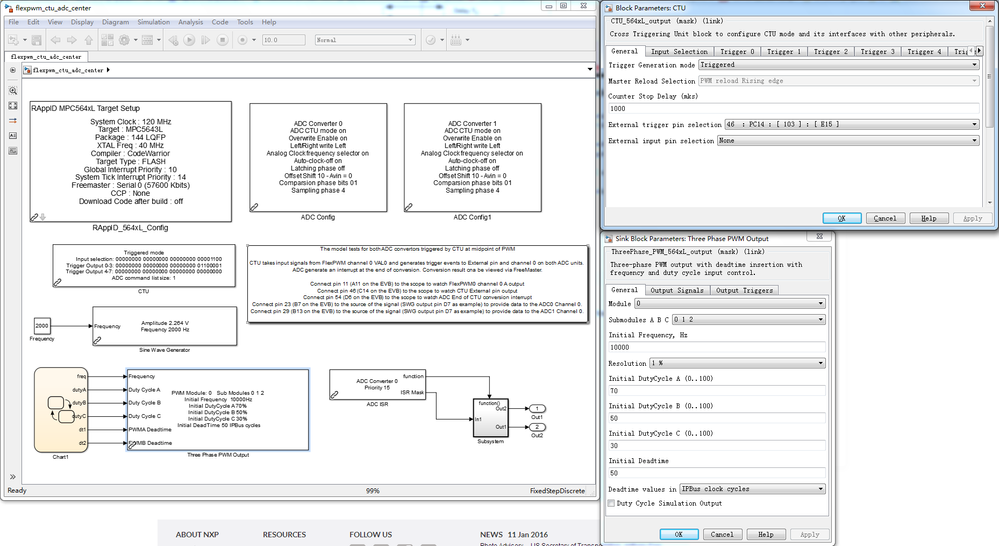

   In the flexpwm_ctu_adc_center.mdl,I find the pwm is 10000Hz,but the Counter Stop Delay is 1000,and the Trigger 0 Delay is 0.Does this mean in one pwm period the ADC measure 10 times?
Hongjin Zeng.

Because the Trigger 0 Delay is 0 it means the ADC will start to measure immediately after the PWM update interrupt occurs (but only once per PWM period). In this case the value of Counter Stop Delay is not too important. Usually you can setup this timer to expire in order to make sure to perform the ADC measurement in a window of time.
