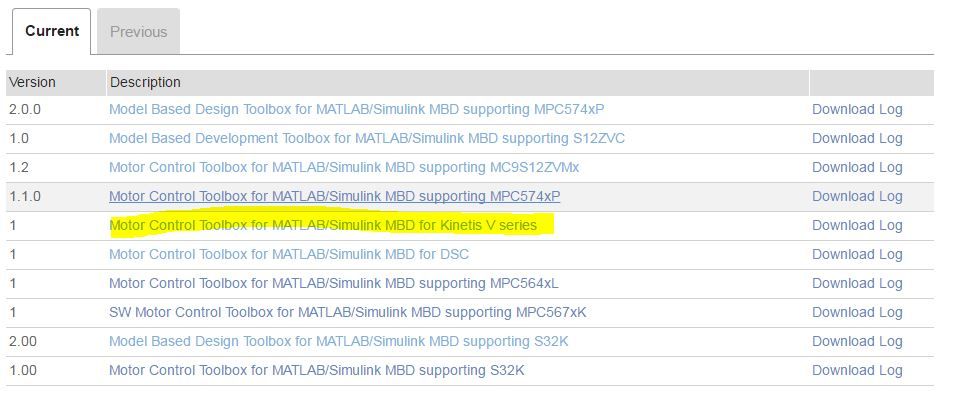

diogocacador
Hi all,
Expanding on Maciek question here, are you planning to add support for the Kinetis V series in the Model Based Design Toolbox?
Also, is it possible to run Processor-in-loop simulation using the currently supported Motor Control Toolbox for the V series?
Kind regards,
Diogo
3,514 Views
Daniel_Popa
Hi Diogo,
Please check the MBD product list
Are you interested in a specific part that is not supported?
Hope this helps!
