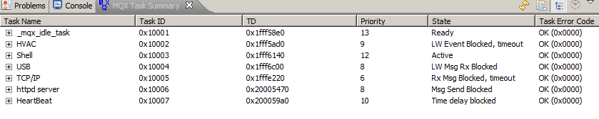

The web_hvac Demo project straight from MXQ 4.0 runs fine on the TWR-K70 system, but if I suspend execution and look at the MQX Task Summary, the TCP/IP and httpd server tasks always have a Task Error Code of 'Out of Memory (0x0004), even if the program only runs a few seconds and I never request a web page.  Anyone know what is causing this and how to increase the memory allocated to these two tasks?  The stack for these tasks has not overflowed, so it is not out of stack memory.  The RTCS_MINIMUM_FOOTPRINT is defined by default as this project comes, which gives _RTCSPCB_max = 20 which seems plenty, and increasing to 40 makes no difference.

I just tried MQX 4.0.1 web_hvac on TWR-K70F120M with CodeWarrior 10.4 (all default settings) and I get this:
This test on a very small network, only PC and TWR, connected via router. Router is not connected to WLAN.
