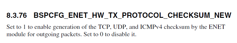

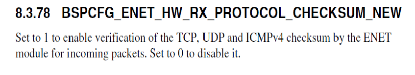

In RTCS, there is a TCP header checksum.    that is,  "  unsigned char    checksum[2];      /* (see RFC) */", this checksum is calculated only for the header bytes. The result of summing the entire IP header, including checksum, should be zero if there is no corruption.  At each hop, the checksum is recalculated and the packet will be discarded upon checksum mismatch.
This checksum is calculated by hardware.
Two configuration options are defined in rtcs/include/rtcscfg.h. You may override the settings from the user_config.h user configuration file
