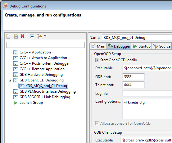

Hi Derek, thank you for posting your demo application.  I've been trying to create my own KDS project with the MQX for KDS SDK module using your walkthrough, and have been unsuccessful thus far.
I loaded your project and then switched the configuration to use the MK64FN1M0VLL12, since that's what my FRDM-K64F has.  The configuration switch went fine, but after code generation, building failed.  The error I got was:
Description    Resource    Path    Location    Type
fatal error: device/MK64F12/MK64F12.h: No such file or directory    fsl_device_registers.h    /MQX_KSDK_PEx/SDK/platform/CMSIS/Include/device    line 427    C/C++ Problem
This is the exact same error I get when I try to create my own project.
Is there something I could have missed?  I have all of the latest Eclipse updates installed.
Thank you!

Ok, it seems that it is related to all of the packages installed on my system, or the fact that I specified the processor and not the board in the New Project wizard.  I reinstalled everything in a clean virtual machine just for testing, and it compiled.  Now the only problem is that I can't debug.  I set the -f kinetis.cfg build option, and when I try to debug I get this error:
Open On-Chip Debugger 0.8.0-dev-dirty (2014-08-20-11:07)
Licensed under GNU GPL v2
For bug reports, read
    http://openocd.sourceforge.net/doc/doxygen/bugs.html
Info : only one transport option; autoselect 'cmsis-dap'
Error: unable to open CMSIS-DAP device
Error: unable to init CMSIS-DAP driver
Error: Error selecting 'cmsis-dap' as transport
Runtime Error: C:/Freescale/KDS_1.1.1/openocd/bin/..//scripts/kinetis.cfg:3:
in procedure 'script'
at file "embedded:startup.tcl", line 58
in procedure 'interface' called at file "C:/Freescale/KDS_1.1.1/openocd/bin/..//scripts/kinetis.cfg", line 3
Can anyone suggest a course of action?
7,610 Views
intractablesubt
I think this is because you are still running the mbed code on your board. If you want to debug using the Segger J-Link you have to flash JLink_OpenSDA_V2.bin to the K20 on the board. To do that you hold down the reset while plugging in the USB cable. That should cause a BOOTLOADER USB Drive to show up on your laptop. You can then drag the JLink_OpenSDA_V2.bin to that device and it will flash the new image. Unplug and re-plug the USB and the Jlink code will expose a new virtual com port as well as a JLink debugger device. If you get the FRDM-K64-QSP.zip Quick Start Package from the Freescale web site there is a subdirectory for OpenSDAv2Applications that has a link to the Segger website with the code. Be sure you get the V2 version.
7,610 Views
dave408
Senior Contributor II
Thanks, William, that hadn't ever occurred to me because of my debug configuration settings:
I figured that if I selected OpenOCD, the mbed firmware would work fine.  Is this not the case?  Note that in this particular case, I followed the tutorial so I specified a debug config, as opposed to opening his project attachment.  Speaking of which, I'll try that next in the VM.
Thanks!
7,610 Views
intractablesubt
I think your choices, at least for the FRDM-K64F and the TWR-K64F120M, are to use the PE Micro OpenSDA or the Segger OpenSDA code. I'm using the Segger on my boards and it's working.
7,610 Views
dave408
Ok -- I'll load the Segger firmware onto one of my other boards so I can keep working in both environments.  Thanks for the suggestion!
7,610 Views

ERROR: Can not read register 51 (FPS18) while CPU is running
ERROR: Can not read register 52 (FPS19) while CPU is running
ERROR: Can not read register 53 (FPS20) while CPU is running
ERROR: Can not read register 54 (FPS21) while CPU is running
ERROR: Can not read register 55 (FPS22) while CPU is running
ERROR: Can not read register 56 (FPS23) while CPU is running
ERROR: Can not read register 57 (FPS24) while CPU is running
ERROR: Can not read register 58 (FPS25) while CPU is running
ERROR: Can not read register 59 (FPS26) while CPU is running
ERROR: Can not read register 60 (FPS27) while CPU is running
ERROR: Can not read register 61 (FPS28) while CPU is running
ERROR: Can not read register 62 (FPS29) while CPU is running
ERROR: Can not read register 63 (FPS30) while CPU is running
ERROR: Can not read register 64 (FPS31) while CPU is running
Read 4 bytes @ address 0x00000000 (Data = 0xFFFFFFFF)
How can i solve this error?
