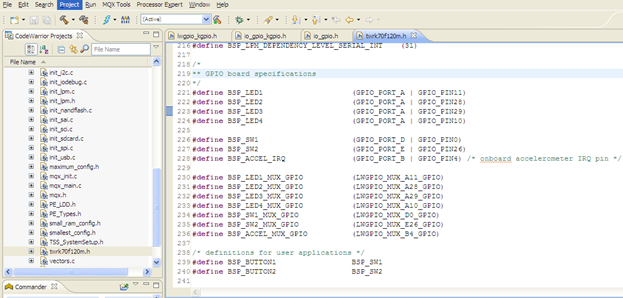

The <board>.h file is used to provide information needed by an application program using the kernel running on the Freescale Evaluation board. This file contains the GPIO board specifications.  It is located at the next path:
<Freescale_MQX_4_x_install_path>\mqx\source\bsp\<name_board>
Figure 1. GPIO board specifications for the TWR-K70F120M.
The twrk70f120m.h file contains the GPIO board definition for the TWR-K70F120M, however if customer creates his own board and he needs to connect LEDs in deferent pins to the TWR-K70F120M, it is necessary to modify this file.
Suppose a custom_board where is connected a LED to PTE18 pin, in order to add this pin definition it is necessary to follow the below steps, the pin will be called BSP_LEDCustom.
1. Define the pin name and assign the port and pin number.
#define BSP_LEDCustom               (GPIO_PORT_E | GPIO_PIN18)
2. Assigning the requested functionality to the pin for the GPIO mode or any other peripheral mode.
#define BSP_LEDCustom_MUX_GPIO (LWGPIO_MUX_E18_GPIO)
3. Save and close the twrk70f120m.h file.
