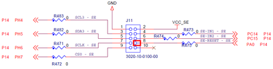

thomasbao
    I used MPC5748G-GW-RDB, the pin I measured is shown in the red box below, and there are no other originals attached to J11.
8,257 Views
lukaszadrapa
After further investigation, I found out that it is known issue in S32DS debugger. I tested your project using Lauterbach debugger and it was working in this case.
It's not fixed yet but the workaround is to not use freeze mode - FRZ bit in PIT_MCR should be 0.
It works as expected in standalone mode without a debugger.
Sorry for inconvenience.
Lukas

lukaszadrapa
it works as expected on my side. I used DEVKIT-MPC5748G and I can see that USR_LED2 connected to PA0 is toggled. Do you measure correct pin?
Lukas
