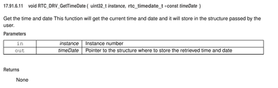

I am using SDK driver. after receiving the CAN message I want time in millisecond . how can I get time in milliseconds using RTC? please guide me.

there's RTC_DRV_GetTimeDate function in the RTC driver:

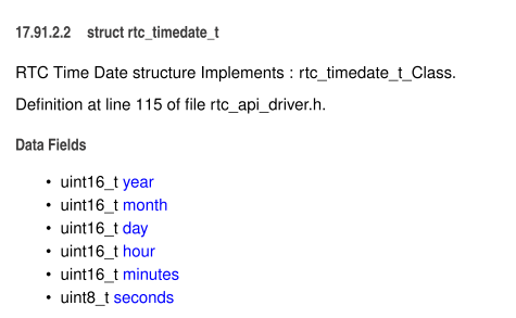

However, the rtc_timedate_t supports seconds only:
If you need to go down to milliseconds, it's necessary to develop own solution using another timer like STM, for example.
