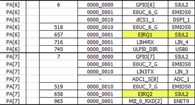

mentioned pins do not have EIRQ function. This is written in the reference manual:
 In the signal description, no EIRQ is mentioned for these pads:
You need to select pads which has EIRQ function. Like this:
Lukas
