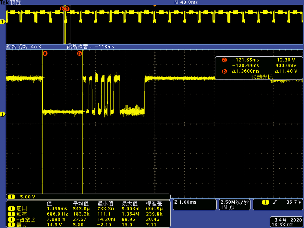

  • The resulting waveform is as follows
  • LIN break field

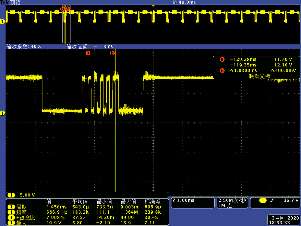

  • LIN synch field
  • tek00001.pngLIN identifier  field
  • The identifier field is wrong from the waveform, so the received data is abnormal.,and the waveform remains consistent regardless of the ID

The actual operation is not as expected,So please help to analyze the causes of this problem. Thanks

how is the LTR defined? Do you really write a BYTE to address offset 0x10?
If LTR is defined as 32 bit register then use this statement
ESCI_B.LTR.R = FrameHeaData[j] << 24;
BR, Petr

Hi, Petr
Thank you for your answer.Your writing is correct.
