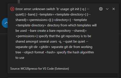

I am trying to do import from Local Archive.
I am importing an RT1060 EVK SDK built from mcuxpresso.nxp.com
My destination is an empty folder inside C:
And I get following error:
Then I find that the created empty folder has disappeared.
Did you see anything similar ?
Hi @Seif ,
 What version of Git do you have? I suspect that you have an older one, so could you please update your local Git and try again?

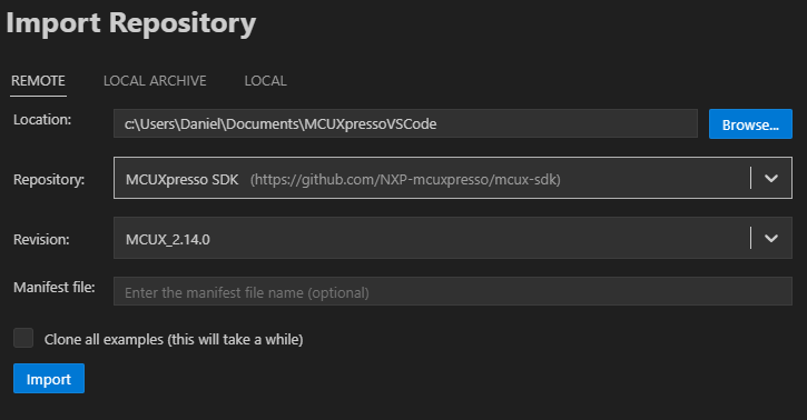

I installed the MCUXpresso for VS Code extension and then ran the MCUXpresso Installer to install additional software, i.e., MCUXpresso SDK Developer, etc.
Then I tried to import a remote SDK repository:

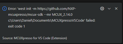

After clicking "Import" button, a small message windows opens an states that the "west" tool failed to import the repository:
The error message is too short to be helpful. How do I get the full error message?

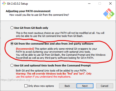

I executed the command manually and it says, that git is not found although git is installed on my system.
I figured that I have to reinstall GIT and during the install process select to add git to PATH variable:
Note that you might need to deselect "Only show new options".
