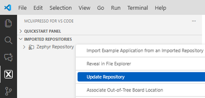

To change the repo version, in the MCUXpresso view, right-click the repo, and select "Update Repository".

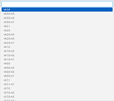

A pop-up appears in the lower-right corner of VS Code.  This may take some time as the tool fetches from the repo.  But then the pop-up shows a short list of versions.
If the preferred version is not shown, click the Custom button.  A pulldown menu opens in the top-center with a full list of tags and branchs.
Updating the repo like this with the MCUXpresso extension is equivalent to running the "git checkout" and "west update" commands.
