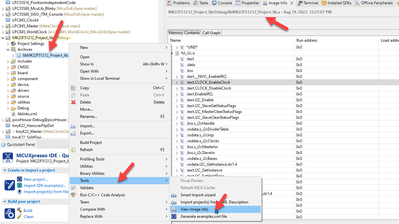

ErichStyger
Specialist I
Can you check the symbols of the peg library, if this is true?
Right-click on the library, Tools > View Image Info
There you should see all the needed symbols, and in the view you can turn on/off C++ demangling.
3,166 Views

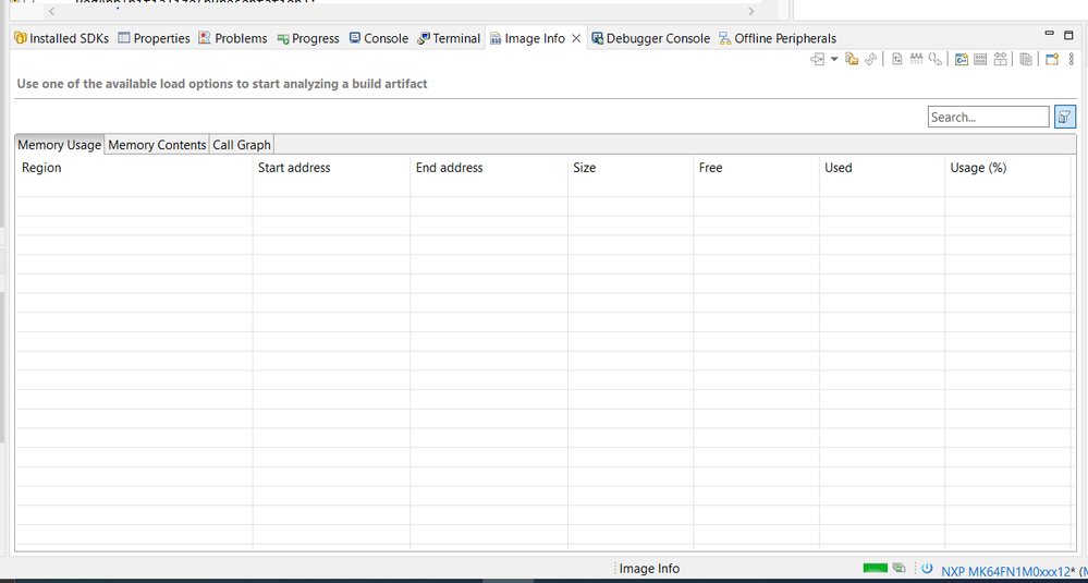

Adarsh317
Hi Erich,
i checked view image info
3,163 Views
ErichStyger
Specialist I
It should look like this:
