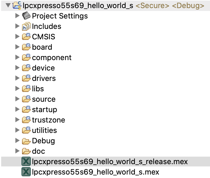

nxa16617
Hi Eugene,
The TEE configuration is not designed with this in mind. There is no functional groups support. However, you could try to work it around by duplication of the .mex file and use one .mex for debug and the second one for release. It is not as simple as #ifdef, but it could work for cases when you do not need to switch between configurations too often.
To switch between the debug and the release, you need to double-click one of the .mex files and press the "Update Project Code" button.
Juraj

EugeneHiihtaja
Senior Contributor I
Hi !
I think multiple mex files is not so strait way to do it becouse it also have gpio pin configurations and etc.
