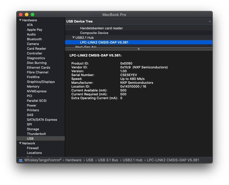

I'm trying to debug a RT1062 target (that successfully debugs under Windows 10 using the same LPC-Link2 and cabling). This is not successful on macOS 10.15.3. MCUXpresso successfully softloads the CMSIS-DAP V5.361 firmware and the probe is detected in the "Probes discovered" window as can be seen in the attached screenshot, but when debugging is about to start it gets stuck in SWD Discovery, followed by a timeout a while later.
Is this a known issue on the later macOS versions?

wj_ueos
This is how it looks like. As mentioned earlier, the debug probe is identified and booted, but SWD discovery never completes.Screenshot 2020-02-19 at 20.22.44.png
