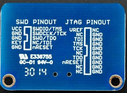

The orientation of the 10-pin connector at the J55 is correct (when I use the reverse connection, JLINK complains about the rest-pin havin an unexpected state). The board is powered via USB and this is working as a green LED is lit. For conversion from the JLink-connector to the tiny 10-pin connector of the board I use this adaptor:
s-l1600
So...any idea what could go wrong here?
