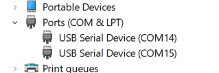

Hi Dave:
I imported this SDK demo , don't change anything,  only link application to RAM
In my Win 10 PC, COM15 is a virtual COM port , enumerated successfully, and can
echo back any character it receives.
Could you please double check it?
