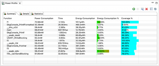

  • Feature: [Power Profile] Added Power Profile feature aiming to correlate energy/power measurement with SWO trace.
Note. This feature requires firmware version MCU-LINK CMSIS-DAP v2.263 (or greater).
  • Feature: [Energy Measurement][Power Profile] Add analog data traffic statistics information for energy/power based views.
