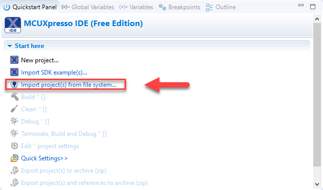

The import project(s) from file system option is included in the Quickstart Panel, which is located in the lower left corner of the IDE.

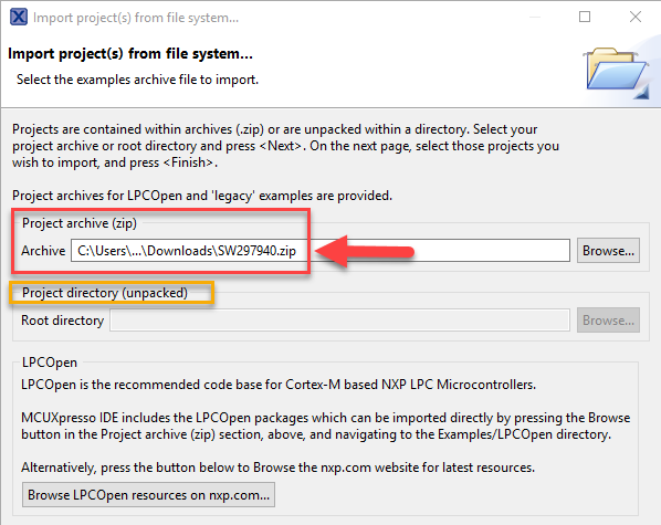

Type / Paste the location of the folder (either zipped or unpacked). Then, click Next button.pastedImage_10.png

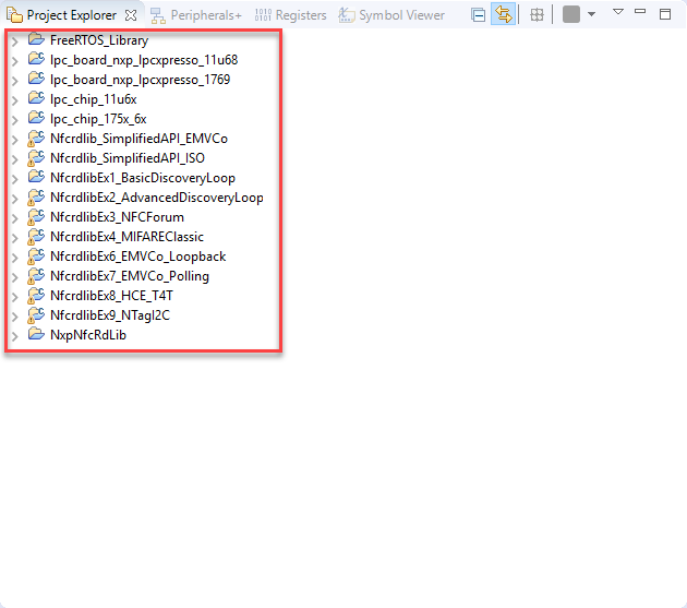

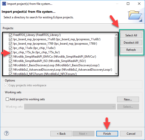

Finally, select all the project folders / examples you want to be imported.
Now, they will be accessible and available from the Project explorer.
