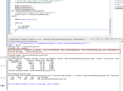

Hello @_ThomasLorenz_
Maybe the change impact other files. You can find all the files compiled in Console view. I have a  tested with SDK demo, only add a variable on hello_world.c file. From the log it only compiles this file:
And you can find the makefile under Debug folder:
Alice
