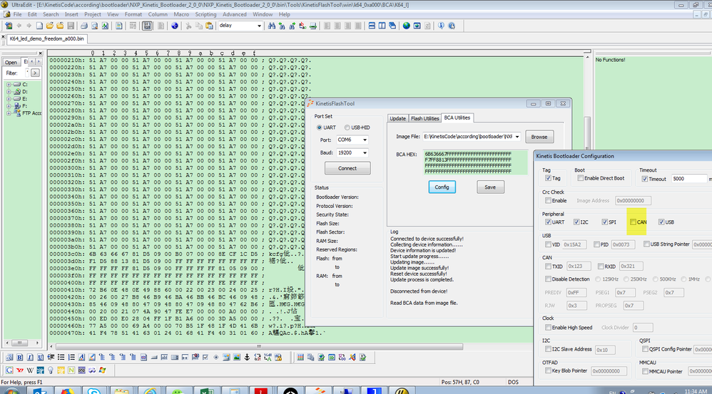

Hi Vincent Garbonick,
  If you don't modify the BCA area, the application code works ok or not on your side?
  Do you mean, just when modify the BCA area, the app function can't work?
This is my test result:
I just disable CAN module, then generate the app again, the code still works OK.
I also attached my app bin file for your reference.
 Wish it helps you!
Kerry

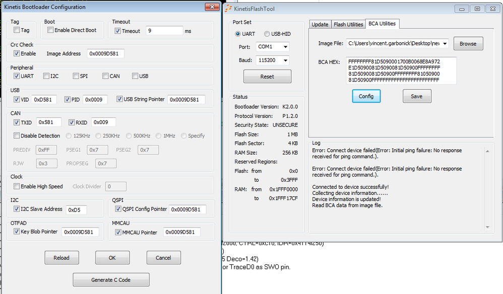

vrg6
Hello Kerry!
   What I am saying is that when our application does not have BCA information, the bootloader does not recognize the application and boot into it. We cannot get our application to work with the bootloader since it does not have BCA information programmed into the .bin image file.
   We need to find a way to add BCA information to our custom project so the bootloader recognizes it.
Thanks for everything,
     Vincent Garbonick

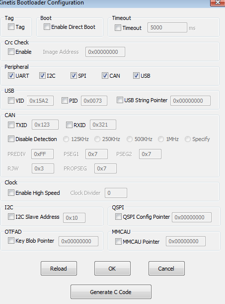

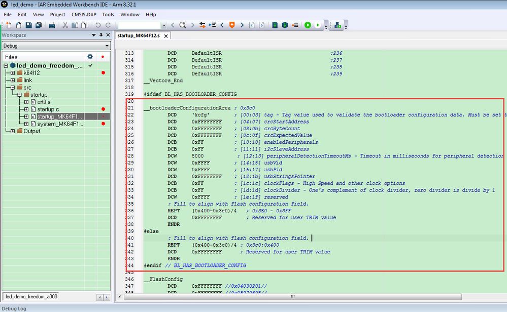

kerryzhou
Hi Vincent,
   If your app don't have the BCA, you can generate the .bin file, then use the KinetisFlashTool to add it automatically.
   Or you in the app source code, just define the BCA area, and add it.
  You also can refer to the KBOOT2.0 k64 APP project:
https://www.nxp.com/webapp/Download?colCode=NXP_KINETIS_BOOTLOADER_2_0_0&appType=license
Folder: NXP_Kinetis_Bootloader_2_0_0\apps\led_demo\MK64F12
Wish it helps you!
Kerry

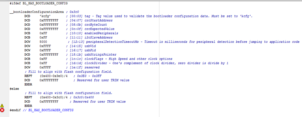

vrg6

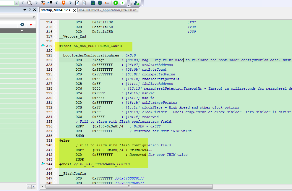

Hello Kerry! Thank you for all your help so far. I was able to follow the steps as you said, but now I am having trouble properly setting up the linker file in order to accept the bootloader configuration information. I added the bootloader_config.c to my project and changed the start address to 0x000A000. I modified the linker file and have been having errors.
I attached a picture of the error message and the linker file. Thank you for your continued support.
/*###ICF### Section handled by ICF editor, don't touch! ****/
/*-Editor annotation file-*/
/* IcfEditorFile="$TOOLKIT_DIR$\config\ide\IcfEditor\cortex_v1_0.xml" */
/*-Specials-*/
define symbol __ICFEDIT_intvec_start__ = 0x0000A000;
/*-Memory Regions-*/
define symbol __ICFEDIT_region_ROM_start__ = 0x00000000 ;
define symbol __ICFEDIT_region_ROM_end__   = 0x000FFFFF;
define symbol __ICFEDIT_region_RAM_start__ = 0x1FFF0000;
define symbol __ICFEDIT_region_RAM_end__   = 0x2002FFF0;
/*-Sizes-*/
define symbol __ICFEDIT_size_cstack__ = 0;
define symbol __ICFEDIT_size_heap__   = 0;
/**** End of ICF editor section. ###ICF###*/
define exported symbol __EXTERNAL_MRAM_ROM_BASE = 0x60000000;
define exported symbol __EXTERNAL_MRAM_ROM_SIZE = 0x00000000;
define exported symbol __EXTERNAL_MRAM_RAM_BASE = 0x60000000;
define exported symbol __EXTERNAL_MRAM_RAM_SIZE = 0x00080000;
define exported symbol __EXTERNAL_LCD_BASE      = 0x60000000;
define exported symbol __EXTERNAL_LCD_SIZE      = 0x1FFFF;
define exported symbol __EXTERNAL_LCD_DC_BASE   = 0x60010000;
define exported symbol __INTERNAL_FLASH_BASE    = 0x00000000;
define exported symbol __INTERNAL_FLASH_SIZE    = 0x00100000;
define exported symbol __INTERNAL_SRAM_BASE     = 0x1FFF0000;
define exported symbol __INTERNAL_SRAM_SIZE     = 0x00040000;
define exported symbol __UNCACHED_DATA_START    = 0x1FFF0000;
define exported symbol __UNCACHED_DATA_SIZE     = 0x00020000;
define exported symbol __UNCACHED_DATA_END      = 0x2000FFF0;
define exported symbol __SRAM_POOL              = 0x1FFF0000;
define exported symbol __INTERNAL_FLEXNVM_BASE = 0;
define exported symbol __INTERNAL_FLEXNVM_SIZE = 0;
define exported symbol __VECTOR_TABLE_ROM_START = 0x00000000;
define exported symbol __VECTOR_TABLE_RAM_START = __ICFEDIT_region_RAM_start__;
define exported symbol __DEFAULT_PROCESSOR_NUMBER = 1;
define exported symbol __DEFAULT_INTERRUPT_STACK_SIZE = 1024;
/* mem_init writes a storeblock_struct at the end of kernel data, max size 32 bytes, so use 0x100 offset */
define exported symbol __BOOT_STACK_ADDRESS = __ICFEDIT_region_RAM_end__ - 0x100;
define exported symbol __KERNEL_DATA_END = __ICFEDIT_region_RAM_end__;
define memory mem with size = 4G;
define region ROM_region   = mem:[from __ICFEDIT_region_ROM_start__   to __ICFEDIT_region_ROM_end__];
define region RAM_region   = mem:[from __ICFEDIT_region_RAM_start__   to __ICFEDIT_region_RAM_end__];
define block KERNEL_DATA with alignment = 8 { section .kernel_data };
define exported symbol __FLASHX_SECT_SIZE = 0x1000;
define exported symbol __FLASHX_END_ADDR = __INTERNAL_FLASH_BASE + __INTERNAL_FLASH_SIZE;
define symbol m_bootloader_config_start = __ICFEDIT_intvec_start__ + 0x3C0;
define symbol m_bootloader_config_end = __ICFEDIT_intvec_start__ + 0x3FF;
define region m_bootloader_config_region = mem:[from m_bootloader_config_start to m_bootloader_config_end];
define block CFMPROTROM with size = 20 { section .cfmconfig };
define block FLASHX_POOL with alignment = __FLASHX_SECT_SIZE { section .flashx };
define block TEXTSECTION with alignment = 4 { section .text };
keep { section .cfmconfig };
keep { section .flashx };
initialize by copy { readwrite };
do not initialize  { section .noinit };
do not initialize  { section .kernel_data };
do not initialize  { section .flashx };
place at address mem:__ICFEDIT_intvec_start__ { readonly section .intvec, block CFMPROTROM };
place in m_bootloader_config_region{ section .bootloaderconfig };
place in ROM_region { first block TEXTSECTION, readonly,  last block FLASHX_POOL };
place at address mem:__ICFEDIT_region_RAM_start__ { readwrite section .vectors_ram };
/* each block/segment must be in one line (association to region) because I need kernel data start after other datas */
place in RAM_region   { readwrite, last block KERNEL_DATA };

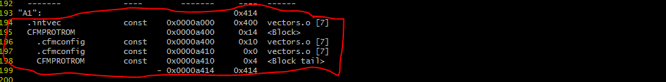

kerryzhou
Hi Vincent,
   What's the code you put in bootloader_config.c ?
  Why you define the cstack as 0?
  Could you also share the linker file before your modification, and which don't have the build problems?
Kerry

About the BCA area add, you totally can add it in the startup_MK64F12.s
#ifdef BL_HAS_BOOTLOADER_CONFIG
__bootloaderConfigurationArea ; 0x3c0
        DCD     'kcfg'        ; [00:03] tag - Tag value used to validate the bootloader configuration data. Must be set to 'kcfg'.
        DCD     0xFFFFFFFF    ; [04:07] crcStartAddress
        DCD     0xFFFFFFFF    ; [08:0b] crcByteCount
        DCD     0xFFFFFFFF    ; [0c:0f] crcExpectedValue
        DCB     0xFF          ; [10:10] enabledPeripherals

vrg6
Hello Kerry!
I have good news. The startup_config.s file you shared works correctly in the application code!
However the problem now is that I don't know how to further configure the bootloader options. I would like to enable the "tag" "direct boot" and "timeout" options but do not know how to begin editing the startup_config.s file.
        DCB     0xFF          ; [11:11] i2cSlaveAddress
        DCW     5000           ; [12:13] peripheralDetectionTimeoutMs - Timeout in milliseconds for peripheral detection before jumping to application code
        DCW     0xFFFF        ; [14:15] usbVid
        DCW     0xFFFF        ; [16:17] usbPid
        DCD     0xFFFFFFFF    ; [18:1b] usbStringsPointer
        DCB     0xFF          ; [1c:1c] clockFlags - High Speed and other clock options
        DCB     0xFF          ; [1d:1d] clockDivider - One's complement of clock divider, zero divider is divide by 1
        DCW     0xFFFF        ; [1e:1f] reserved
        ; Fill to align with flash configuration field.
        REPT    (0x400-0x3e0)/4   ; 0x3E0 - 0x3FF
        DCD     0xFFFFFFFF        ; Reserved for user TRIM value
        ENDR
#else
        REPT    (0x400-0x3c0)/4 ; 0x3c0:0x400
        ENDR
#endif // BL_HAS_BOOTLOADER_CONFIG
Thank you for everything!
26,562 次查看
kerryzhou
Hi Vincent,
   Thank you for your updated information.
   You can delete the following yellow area, then build again, then check your .hex file, you will find the according tag area:
Kerry

vrg6
Hi Kerry,
That's not really what I meant. I was wondering how you could set these options
in startup_config.s code. I don't know how I would go about changing the hex values in a way that affects the BCA information.
Vincent
26,562 次查看
kerryzhou
Hi Vincent,
   About this area knowledge, please refer to my attached document.
Chapter 4.4 BCA utilities tab page
Chapter 4.5 Bootloader configuration page
  Chapter 5.8 Integrate config file to user project
  If you have time, I suggest you read all the document, you will be clear about it.
  Wish it helps you!
Kerry
