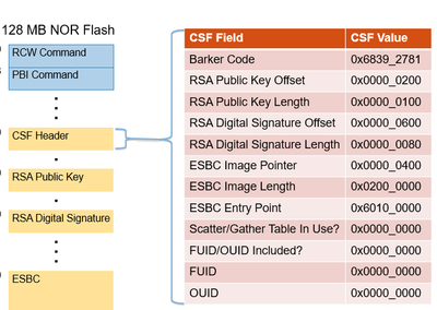

Chavira
For RCW should be the same direction for cf the sign it is at the same time as u-boot.bin.
The BL31 is signed on fip.bin in that contains bl31 and bl33.
This is the map for the RCW sign.
We have a very explained tutorial for LS1043 but I can't publish that file here, please open a case following the link and mention my name on the case to provide you with the file.
