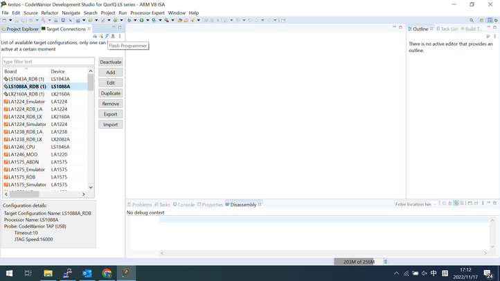

Have you modified FLASH_TYPE = "qspi" in C:\Freescale\CW4NET_v2020.06\CW_ARMv8\ARMv8\gdb_extensions\flash\cwflash.py?
You could do flash programing in CodeWarrior IDE.
In Target Connections panel of CodeWarrior IDE, please duplicate LS1088A_RDB to generate LS1088A_RDB(1), then click the flash programmer icon to do flash programing.
