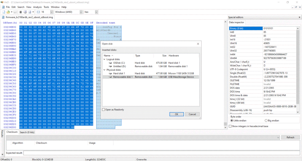

  2. Format SD card.
  3. Open HxD editor and run as administrator.
  4. Open firmware_lx2160ardb_rev2_uboot_sdboot.img binary file in HxD editor.
  5. Copy the binary file (CTRL + A and CTRL + C).
  6. Plug the SD card either directly into the slot available on your Windows machine or using a memory card adapter/reader.
  7. Open disk (SHIFT + CTRL +D).
    Open diskOpen disk NOTE: Uncheck the 'Open as Readonly' option while opening the disk.

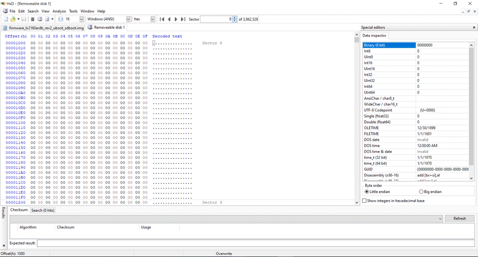

  8. Go to SD block (or sector) 8 (0x1000).
    HxD Editor - Sector 8HxD Editor - Sector 8
  9. Paste the copied binary image content (CTRL + B). Make sure to copy the image at SD block no. 8.
  10. Save the content.
