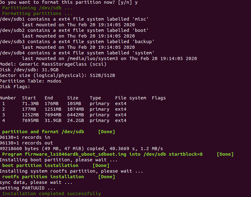

I use flexbuild_lsdk1909_update_221019
#flex-installer -b bootpartition_LS_arm64_lts_4.19.tgz -r rootfs_lsdk1909_LS_arm64_main.tgz -f firmware_ls1046ardb_uboot_sdboot.img -d /dev/sdb
why except system ,others partition  is NULL ?
where find Image.gz / Image / fsl-ls1046a-rdb.dtb ?
CONFIG_BOOTARGS="console=ttyS0,115200 root=/dev/mmcblk0p4 earlycon=uart8250,mmio,0x21c0500 mtdparts=1550000.spi-0:1m(rcw),15m(u-boot),48m(kernel.itb);7e800000.flash:16m(nand_uboot),48m(nand_kernel),448m(nand_free)"
why also boot with yocto:tiny filesystem ?
