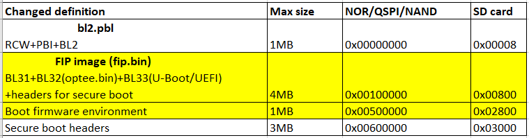

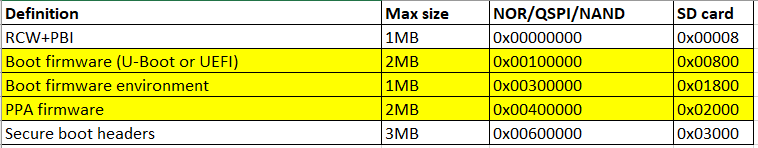

The following figures highlight the changes in the flash layout for previous boot flow (with PPA) and flash layout for TF-A boot flow.
Flash layout for previous boot flow (with PPA)
Changed flash layout for TF-A boot flow
