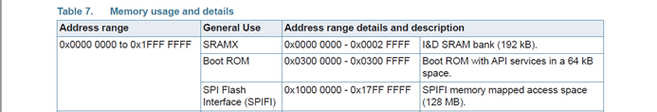

According to the datasheet I can use this much space(0x1000 0000 - 0x17FF FFFF) for SPI Flash Interface,
What I am trying to do store around 400kbytes of memory in flash and save the program memory in the flash at the same time is it doable?

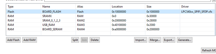

This is how the memory detail looks under MCUXpresso, I'm guessing I can make the partition here, but not sure,

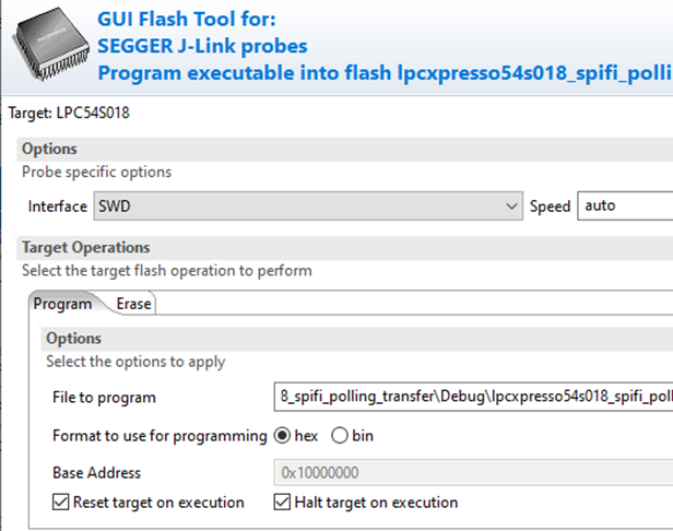

Another thing I noticed,
Do I need to change, the starting address for storing my data in RAM, because it is the same as where I download my code as shown in the picture below?
/* @brief SPIFI start address */
/#define FSL_FEATURE_SPIFI_START_ADDR (0x10000000)
Also how can I find out in which particular location in the flash the program memory is stored? Just to make sure it doesn't overlap with my data in flash?

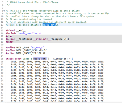

As you said that you wanted to store 336kbytes of constant data, but the LPC54018 has only 360 kB on-chip SRAM, you have to allocate some space for stack, global variable, even heap.., because you do not want to change the constant array, it is not necessary to copy constant data from flash to on-chip RAM.
The constant array address is allocated by compiler, your application code is not required to know the constant array address.
You can read the constant data array directly.
Hope it can help you
XiangJun Rong
3,122 Views
xiangjun_rong
you can use the line to read data from spifi flash:
uint8_t char_1;
char_1=model_data[1];
