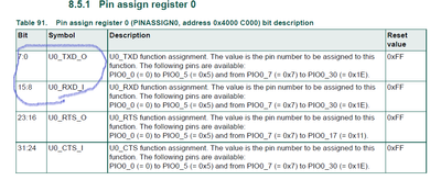

I want to use LPC804M101JDH24 for serial communication. I have attached code which is not working.
It seems that the character is not received. I have used PIO0_4 and PIO0_0 as TX and RX and linked all necessary header files as well.
Please suggest what is wrong in code.
Thanks in advance.

You gave us only part of code, I do not know if you understand how to initialize the SWM:
Enable_Periph_Clock(CLK_SWM);
SWM->PINASSIGN_DATA[0]=0x0000;
SWM->PINASSIGN_DATA[0]|=4<<0|0<<8;
Then PIO0_4  will function as UIART0_TXD, PIO0_0 will function as UART0_RXD
If the uart0  receiver can not get char, pls check the baud rate.
Hope it can help you

Well I have included swm.h file, which is attached here.
Also, baud rate is 9600 which is not an issue.
Please help.
Thank you.

Pls write a code to repeat to output char, then connect a scope to an scope and check if you can see the waveform and check the baud rate.
