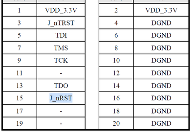

HI, I have designed a proto-type board for LPC1768 micro controller .I would like to know what are all the possible ways to program it for 1st time .

I think you can populate a standard 20 pins male JTAG connect on your PCB board with 100mil pitch, you can use J-Link or the other device to download/debug the board of LPC1768.
This is the 20 pins JTAG connector pin assignment.
Hope it can help you

To program for the first time, you can use a debugger, connected via the SWD/JTAG port, or use FlashMagic to program via the USART.
For the debugger, you will need a debug probe, such as LPC-Link2 or the new MCU-Link, which cost about $15 each and to use the free MCUXpresso. You will also need the SWD circuit described here
https://community.nxp.com/t5/LPCXpresso-IDE-FAQs/Design-Considerations-for-Debug/m-p/469565
If you are going to write any code, having a debugger will save you a lot of time, so it is better to make sure you can use it from the start, rather than have to re-engineer you board to add it later.
