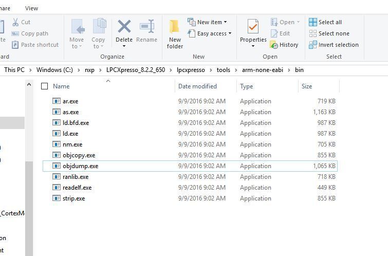

What are you trying to do with these files - what do you mean by read them? Which tools created them?
there are tools in lpcxpresso for decoding the contents of .o, .lib etc files - objdump, for example.

Thank you very much for your reply. I wanna actually see after building up, what all things are actually going to happen inside. That was the reason, I was looking forward to reading these files. (AS SHOWN IN THE FIG. objdump.exe)

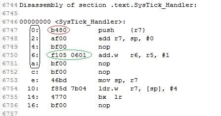

Also, I have tried to read the .o file (in the file explorer, after building up the script it was generating), by using the binary utilities > dissemble. But, in that one, I am not understanding the different values: I mean, which number is mentioning what?? (As shown in the figure, If you can help me out)

The numbers circle in black ("0:" "2:" etc) are the address. As you have decoded a .o file, they are relative the the start of the file. If you had decoded and .axf file, it would be the absolute address.
The other numbers are the hex value of the instruction. As you can see, some are 16-bit instructions (circled in red), while others are 32-bit instructions (circled in green).
