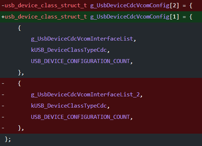

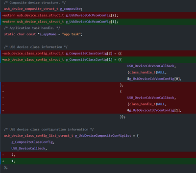

This example project can let pc detected 2 comport and echo,but i only want to use one comport.
I try to modify
composite.c
usb_device_config.h
usb_device_descriptor.c
but two comport all disappear.
Any wrong?What should I do?

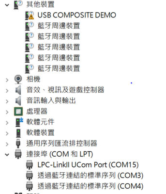

In the readme of the lpcxpresso55s16_dev_composite_cdc_msc_freertos it is explained that you might need to Update the Driver Software for cases where the device is enumerated as USB COMPOSITE DEMO. As the readme mentions, if you had updated the driver, the device would have appeared as a Virtual COM Port.
Best regards, Raul.
2,555件の閲覧回数
javenhuang1998
Hello @RaRo ,
I follow the step and get this result.
Javen.
