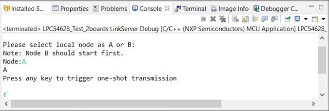

Hello!
I am working with two #LPCXpresso54628 boards and trying to implement a CAN communication between them.
I implemented the following SDK example which used CAN0 with the aim of visualizing a message transmission, but the boards do not receive anything.
This is the code:

PRINTF("Please select local node as A or B:\r\n");
PRINTF("Note: Node B should start first.\r\n");
PRINTF("Node:");
node_type = GETCHAR();
PRINTF("%c", node_type);
PRINTF("\r\n");

if ((node_type == 'A') || (node_type == 'a'))
PRINTF("Press any key to trigger one-shot transmission\r\n\r\n");
else
PRINTF("Start to Wait data from Node A\r\n\r\n");

This example links the boards between Node A (Transmitter) and Node B (Receiver) whose functionality is to send a value from the keyboard and then show it on the console, but it does not work.
I attach an image of the console messages.
Board 1:
Board 2:
 I will thanks if someone could support me.
