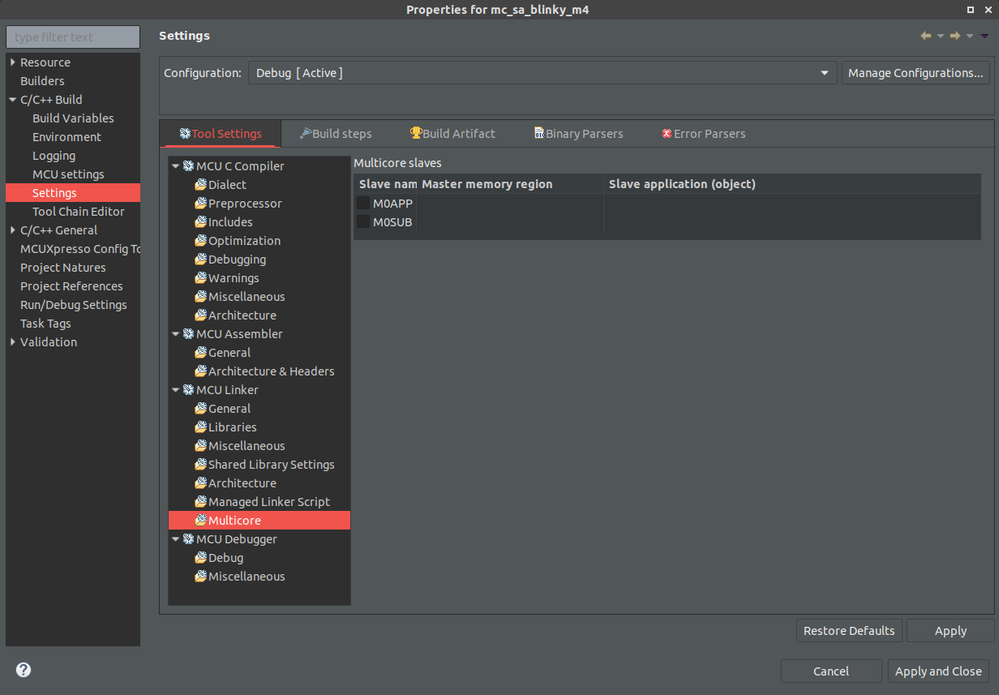

I noticed that mc_sa_blinky_m4 is not configured for multicore? I'm a bit confused at this point :smileysad:
Thanks for the help! As I will figure out what is not working I will write down a post to explain everything:)
Best,
Andrea
26,230件の閲覧回数
ZhangJennie
Hi Andrea Bettati
This is a known issue of MCUXpresso 11.0.1. This problem has been fixed in v11.1.1. Please download the new version from here
