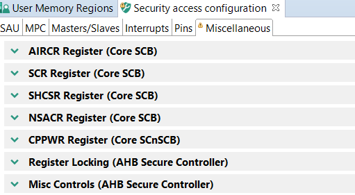

But it seems to me the same system register can be configured via ConfigTool in TEE section Misc.
I would like to disable all co-processors usage on secure and nonsecure side. Only FPU need on both sides.
Can I do via ConfigTool TEE section only ?

Hello  Eugene Hiihtaja,
In the Trusted Execution Environment, or TEE tool, you can configure security policies of memory areas, bus masters, and peripherals, in order to isolate and safeguard sensitive areas of your application.
Refer to your description, it seems the "Miscellaneous" view can meet your requirement, the list of these options depends on processor data.

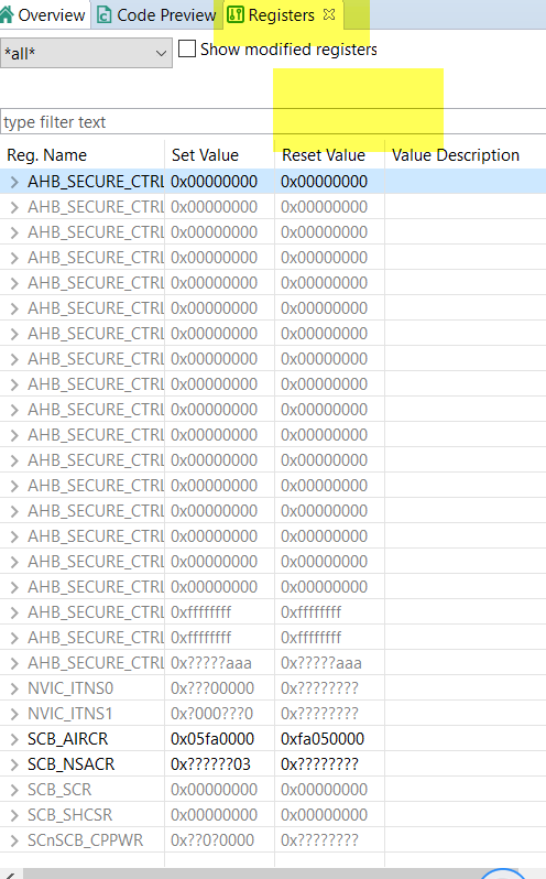

All the options influence your register settings, and can be inspected in the Register view.
