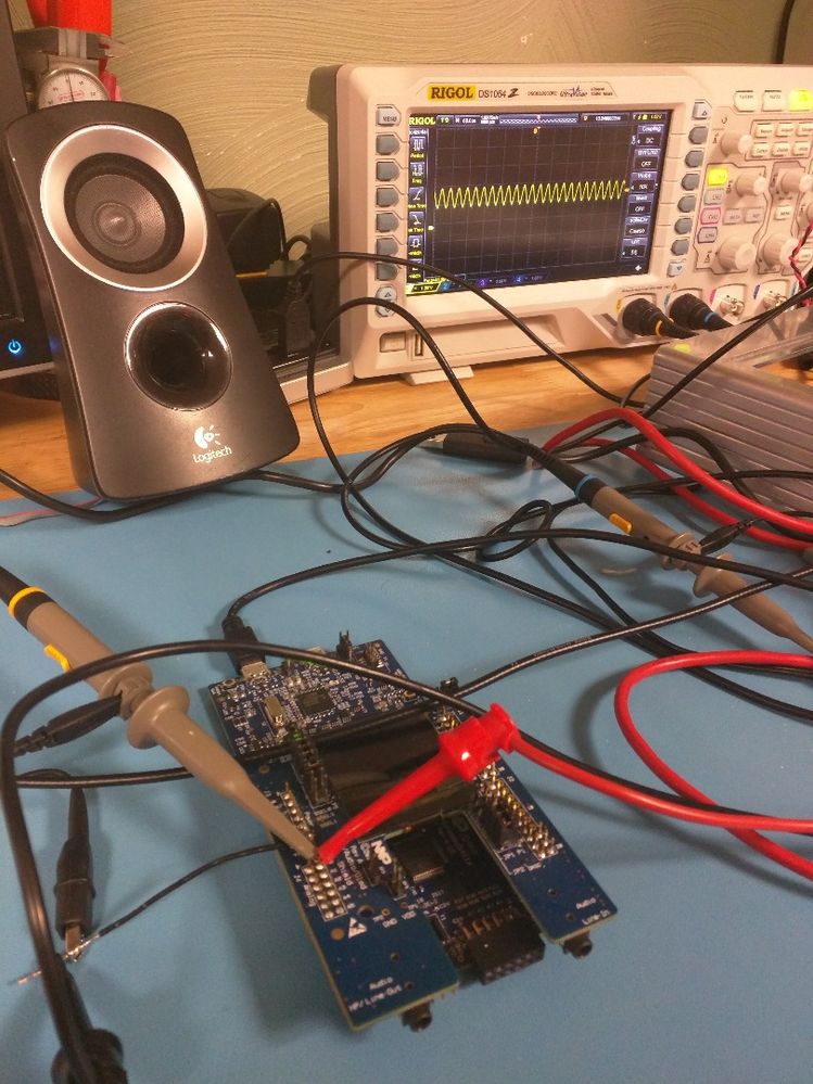

Hello:
Introduction:

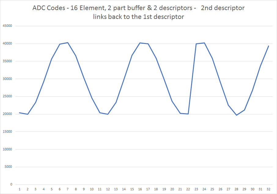

I am having a difficult problem with the DMA engine in the LPC54114.     I am trying to use the DMA in a continuously linked transfer described on page 160 of User Manual 1.4 UM10914.       Instead of a ping pong,  I am setting up 4 descriptors where the last one links back to the 1st.   I am transferring data from the ADC into some memory buffers.   To test,  I am feeding the ADC with a known frequency sine wave.
Observed Issue:
The 1st four transfers always work OK.   If I terminate the transfer at the 4th descriptor,  I can looked at the data and it is correct.     If I link the 4th descriptor back to the 1st,   data in my memory buffer is incorrect after the 1st four transfers.   It looks like it is ADC data BUT it is out of order.    I cannot find a pattern to the out of order data but it only appears to occur after the 1st set of 4 descriptors are executed.
Also note,  that the DMA is continually operating.  It is doing the correct number if transfers,  it just is not moving to the correct destination addresses.   It does appear the DMA is moving data into the correct region,  but the actual ordering is messed up.    I am monitoring via a pin on an o-scope when I get a DMA IRQ as well as when the ADC is triggered via the SCT.   I get ADC & DMA pulses at the correct rate, etc.
Background:
Here is a description of of the DMA setup.
      *  We need a total of 5 Descriptors
      * 1 Descriptor that is in the main SRAM table to start
      * 4 to maintain the continuous transfer.    (See Page 160 of User Manual 1.4 UM10914)
      * There will always be 1 buffer getting new data while the other 3 are being processed.

  I am using the setup to get a set of 4 buffers such that I can have 4 at any time to process
 In the figure below,   B0,B1 and B2 form a complete buffer that
 needs to be processed.   Since we are doing overlaps of 3,
 we can wrap the pointer to the data exactly when we need to.
 Buffer State      0               1              2              3
              |   Just   |   |          |   |          |   |  Next To |
              |  Filled  |   |          |   |          |   |    Fill  |
              |    B2    |   |    B1    |   |    B0    |   |          |
              | Next To  |   |   Just   |   |          |   |          |
              |   Fill   |   |  Filled  |   |          |   |          |
              |          |   |    B2    |   |    B1    |   |    B0    |
              |          |   | Next To  |   |   Just   |   |          |
              |          |   |   Fill   |   |  Filled  |   |          |
              |    B0    |   |          |   |    B2    |   |    B1    |
              |          |   |          |   | Next To  |   |   Just   |
              |          |   |          |   |   Fill   |   |  Filled  |
              |    B1    |   |    B0    |   |          |   |    B2    |

I tried 1-4.   None of them had an effect by themselves BUT if I combined them,  I got different behavior.   if I set the descriptors for ping pong like in 2.),   Set the DMA transfer size to 16,  Set the Match reload to 1000 AND the the ADCCLKDIV to 15,  the data looked better.    It still isn't correct as the waveform is being chopped in unexpected locations.
Notice the discontinuity at sample 22.   I would expect a discontinuity at 16 or 32.....
With this same setup, If I use 4 descriptors,  it would break again.
Also,  if I change the DMA transfer size (say to 32 or 64),  the data is messed up like before.    there seems like a strange interplay between the ADC and DMA controller.
Let me know if there are any other tests I can run here.   I have tried many permutations and I think there is some sort of synchronization bug in the chip.

I have zipped my project Files.  There are 6 Projects to be imported.    It is a dual core setup for the LPC54114 so I included the M4, M0 Projects as well as the chip and board support libraries.   The "M4" project is where all the code is at. I am using LPCXpresso 8.2.2
Now,  I have some details about the tests I ran to illustrate the behavior I am observing.
For my setup, I am using am LPCXpresso 54114 board with the OLED shield.   (The OLED shied really isn't used but it is plugged on top).   I am feeding header Pin A0  (which is ADC Channel 1) with a 30KHz sine wave.   The DC Offset is 1.5v and the amplitude is 1v.
TEST 1
In the M4 Project,   uncomment line 189 and comment out Line 186:
     //Link back to the 1st descriptor
     //ADC_TransferDescriptors[3].next = (uint32_t)&ADC_TransferDescriptors[0];
     //For a test,  stop the transfers here.   The sine wave will look fine.
     ADC_TransferDescriptors[3].next = 0;‍‍‍‍‍‍‍‍‍‍‍‍‍‍‍‍‍‍‍‍
In this test case,    the DMA will capture four blocks of 8 samples from the ADC.    There is a 32-element array called "CaptureData"  that the 4 descriptors point to.    Here we are terminating the DMA oepration by setting the "next" field to "null" in the final descriptor.
Download and run the code.   If you pause the program and look at capture data in the watch window, you can get data that looks like this:  (I plotted in Excel)
The waveform looks correct.    CaptureData is a 32-element array of 16 bit unsigned values (the upper 12 are the ADC Codes).  The mean value looks correct as does the amplitude.   Pretty much a text book data capture.
